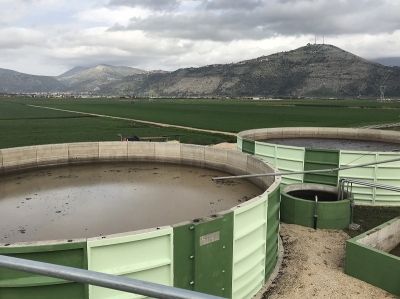

The plant consists of scrapers and pipelines, collecting all the manure from the stables into a pre-treatment tank, which homogenizes and equalizes the material. This tank is connected to an anaerobic digester system equipped with submersible mixers. At this stage, different bacterial strains digest biomass in an oxygen-free environment at temperatures similar to those in a buffalo’s stomach. As a result of this biochemical process, bacteria break down complex organic substances, generating a methane-rich biogas.
The gas produced in the digester moves upwards, towards the dome, and is then directed to a gas treatment unit, where a thermal process helps to purify the gas, increasing the concentration of methane. The end product is sent to a gas-powered generator, which produces enough electricity push power back to the grid.
