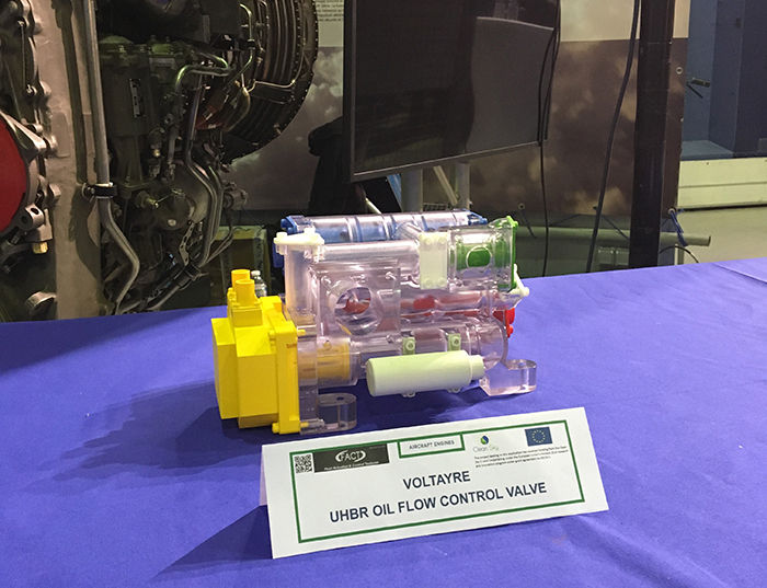

VOLTAYRE is focused on the design and manufacture of an innovative high flow direct drive oil valve, which will be qualified to TRL 5 level. The valve will be able to meter accurately and split the flows coming from the pump to the gearbox and to the engine.
That’s where the Clean Sky VOLTAYRE (valves for oil regulation with high accuracy and reliability) project comes in. With the support of the European Commission’s Horizon 2020 funding, VOLTAYRE is focused on the design and manufacture of an innovative high flow direct drive oil valve, which will be qualified to TRL 5 level. The valve will be able to meter accurately and split the flows coming from the pump to the gearbox and to the engine, allowing the excess oil flow to return to the tank. The valve will also communicate a visualization of the delivered oil flows with the FADEC (full authority digital engine control).
The VOLTAYRE concept is based on the upsizing of a patented electronic free low energy limited angle torque motor developed by FACT (Fluid Actuation & Control Toulouse), an SME based in L’Union, France. The company has developed a torque motor which provides high torque, high displacement, high ageing stability, and without dynamic seals which is able to directly drive a spool that can meter and split an oil flow.
“Due to the large range of power, we need to reach a large range of oil flow,” says Sébastien Oriol, topic manager at Safran for the VOLTAYRE project. “It’s quite a new component because we have never done an oil flow measuring unit before.”
