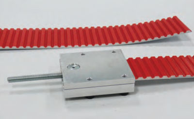

Brecoflex CO., L.L.C. is pleased to introduce the newest belt option in its move-series, the AT10move-M. This open-ended version joins the successful BFXmove truly endless timing belt that was launched in 2015. The move-series represents the next generation of timing belts, offering up to 75 percent higher stiffness and 30 percent higher transmittable force than the standard AT10 belt.
The advantages of AT10move open-ended belts include:
•75% higher stiffness and tensile strength
•30% higher transmittable force
•permits reducing the belt width by one standard size
•narrower drive reduces drive inertia and noise
•reduced wear and increased service life
In linear drive applications, the high tensile strength and high stiffness of the "move tension members" ensure faster settling and more accurate positioning with a very high degree of precision. The high load-bearing capacity of the tension members, optimized tooth shape and low-friction coefficient of the belt coating provides advantages in applications where long service life and low friction are important. These properties proved superior for BFXmove, and will make AT10move–M the most outstanding option for linear drives.
Move-series AT10-M is currently available in 25 mm, 32 mm, 50 mm, 75 mm and 100 mm widths with galvanized steel tension members.
