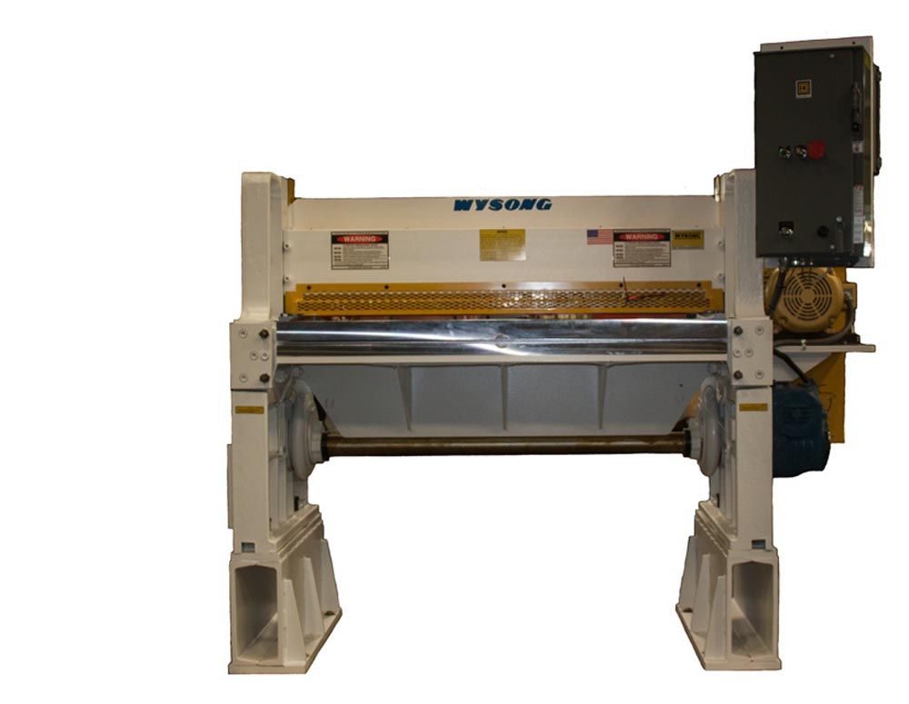

Wysong USA is a manufacturer of industrial press brakes, hydraulic shears, and mechanical shears for sheet metal and plastics that have been around for nearly 120 years. Like many companies, their motto was “If it ain’t broke, don’t fix it,” so their product remained essentially the same for quite a while. But during a customer visit that motto clashed with another company saying, “The customer is always right.” This customer had changed out the dry clutch brake for an oil shear clutch brake that was more accurate. Well, “the customer is always right” won out, so Wysong updated their product line and not only increased accuracy but also reduced costs, making it a win all around.
Wysong Shears cut sheet metal and sheet plastic for companies making large automotive components, tractor hoods, and lawnmower hoods, among others. Often the presses run 24/7, so accuracy, repeatability, and durability are key factors. As the business has shifted from sheet metal to plastic sheets, customers have been looking for increased accuracy.
Their shears are used to cut plastic from 60-in. wide to 10-ft. wide, in thicknesses from 30-thousandths of an inch to five-eighths inch, like those used for lawn tractors. They typically operate from 60 strokes a minute to upwards of 200 strokes a minute.

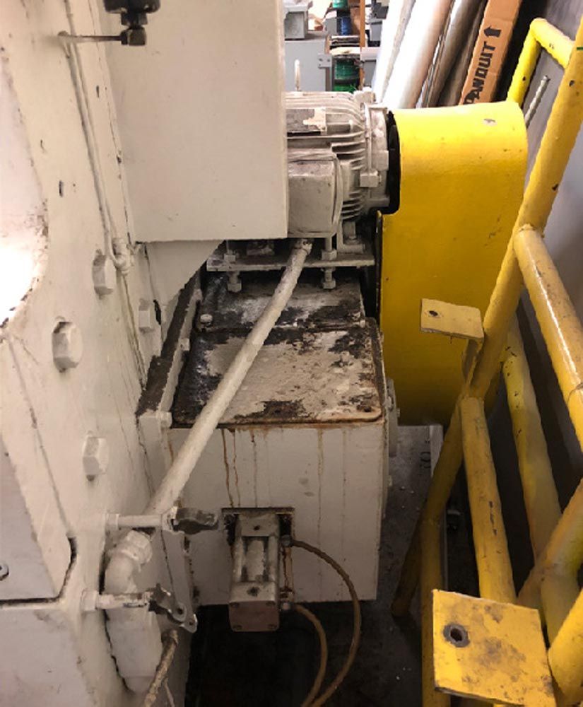

Wysong formerly used a clutch brake in their shears. These shears are designed to run at 60 strokes a minute and include a flywheel to overcome inertia and an encoder on the chain drive cam switch. Depending on the speed, the flywheels could get rather large, up to 40-in. tall in some cases. Because there is inherent fluctuation with a chain drive, the accuracy of the encoder was not optimal. The encoder certainly helped, but slight inaccuracies over time meant manual adjustments were typically required, either by an operator or by maintenance personnel. The old-style designs also needed maintenance every year, to the tune of about $4,700 for the parts, plus two to three hours to change out the parts. Once reassembled, the shear had to be manually finessed to ensure it was running properly before production could resume.
Old design with original clutch brake.

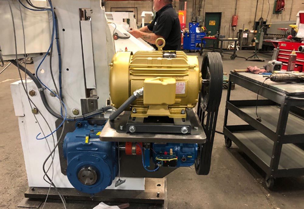

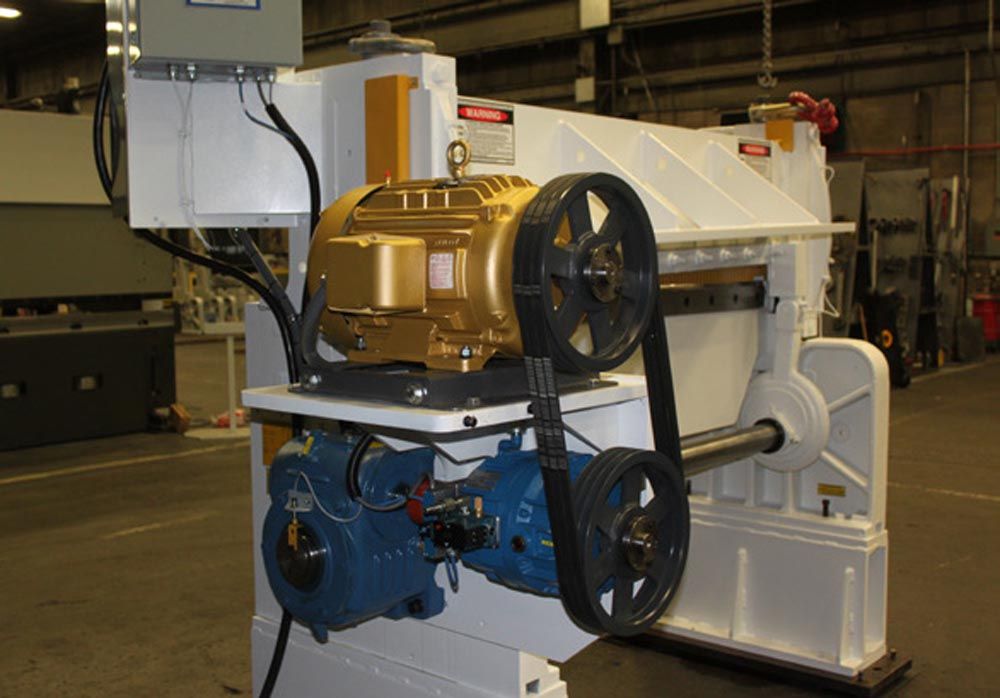

The new Force Control clutch brakes are very different and require far fewer auxiliary components to operate. There are no flywheels, and one Force Control Posidyne model 3 clutch brake replaces a pair of clutch brakes, so the cost savings add up quickly. The old-style design required a D-style motor with high slip to allow the motor to accelerate the flywheel up to speed. Eliminating the flywheel allowed Wysong to utilize a much more common (and less expensive) B-style motor.
“We use just one Force Control, and we connect to a worm drive gear which we mount to the side frame,” said Summers. “Then we have a motor sitting on top. It’s all caged in. We’ve designed it to mount to a plate that we can easily remove.”
By replacing the dry clutch brakes with Force Control brakes, the shears achieve much greater accuracy and repeatability and are far more cost-effective in terms of manufacturing and maintenance. “The repeatability standpoint is a night and day difference. On the old version, you’ve got the brake and then you’ve got the clutch that’s on a flywheel. It’s all one set of air,” says Summers, “so there is only so much adjustment available. With the Force Control, we have the manifold with the air adjustment for the brake and the clutch. You can run more air on the brake and less on the clutch. It’s separate, whereas on the original it’s all one. With the Model LC, the Force Control corrects itself automatically.”

Posidyne retrofit with worm gearbox.
