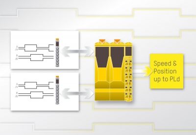

B&R makes it easier to create safety applications with a series of new mapp functions in SafeDesigner. It is also possible to use a combination of data from the standard application to generate safety-relevant data.
The Data-to-SafeData function determines a safe speed and a safe position using data from the standard application. This is done by comparing speed and position data from two standard (non-safety) I/O modules with each other. With the help of the functions provided, the data can be used as the safe speed for applications up to PL d and the safe position for applications up to PL c .
