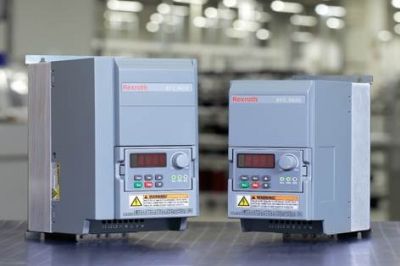

All over the world, industrial end-users are demanding energy-efficient machines and equipment to significantly reduce operating cost and reduce their carbon footprint (CO2 emissions). By using demand oriented electromechanical energy, users are able to take vital steps in the right direction achieving those goals. Speed-controlled induction motors in variable speed pump drives for example can reduce electricity consumption by up to 80 percent in comparison to fixed-displacement drive applications. The EFC 3610 and EFC 5610 frequency converters from Rexroth address these potentials simply and economically. Scalable in performance and functionality features, the drives can be integrated into a wide range of automation environments with simple commissioning and open interfaces.
The intelligent frequency converters control speed as demanded, thus significantly reducing the energy consumption of pumps, compressors and fans. The frequency converters commonly known as variable frequency drives (VFD), AC drives or variable speed drives (VSD) can be integrated into many types of applications and machines as compact units for speed and torque control. Together with permanent magnet motors, the frequency converters increase energy efficiency and the adaptive pulse adjustment of the PWM frequency, minimizes motor noise at the same time. Integrated energy counters measure actual consumption and capture valuable information for the energy usage optimization of machines and systems.
Commissioning without a PC
With the integrated control panel, commissioning can be done easily without external programming devices or a PC. From there, the user can start auto-tuning and enter, change or backup parameters. With switchover options between parameter sets and integrated PID control to increase flexibility as well as extensive connectivity options like Multi-Ethernet interface option (Sercos, EtherNet/IP, PROFINET, EtherCAT, and Modbus/TCP), designated fieldbus options (Profibus DP and CANopen) and additional I/O options, the devices are suitable for most machine applications.
The removable LED operator display panel shows all operating variables and has an integrated copy function. This accelerates the commissioning of several frequency converters with the same or similar parameter set and reduces the work required when exchanging equipment or in series production.
