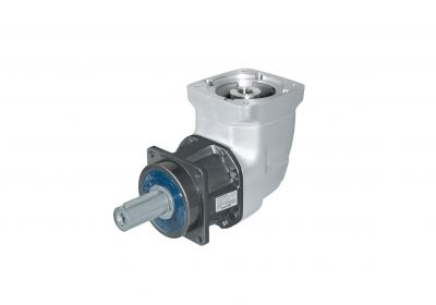

Bonfiglioli Announces New TQK Series Right-Angle Precision Gearbox
Bonfiglioli recently announced the new TQK series -- Right-Angle Precision Gearbox version. This precision gearbox is complementary to the TQ series and offers maximum power density and features a space-saving installation solution.
TQK is particularly suitable for dynamic positioning applications for packaging and machine tooling as well for flat-bed machinery for wood working. In addition, it can carry out continuous running applications necessary for printing and paper converting.
TQK features a design in 5 sizes (060, 070, 090, 130 and 160), ratios from 6 up to 200 due to its design based on one and two reduction sizes, all this with a nominal torque from 30-800 Nm. Furthermore, its housing design and mono-block planetary carrier provide a high torsional stiffness that can meet any application requirement from a faster dynamic to a higher number of stops and reverse cycles. The optimized planetary full-needle roller bearings allow for a higher torque output due to the maximizing of the contact points and increased stiffness, reduced wear and backlash.
The TQK Series is equipped with higher-rating bearings that can handle higher radial and axial loads, and the reinforced bearing options extend higher performance. Its design is also suited for S1 & S5 operation with a very reliable catalog rating and selection procedure.
