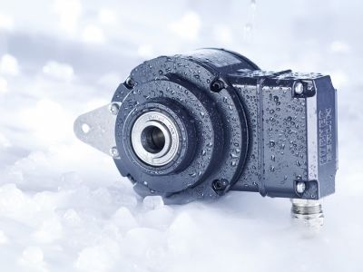

Baumer Hübner offers a broad portfolio of HeavyDuty encoders. Manufacturers of cranes and hoists are among the most frequent users of such sensors. And for good reason: These applications are most demanding and here they can play to their strengths - robustness, precision, resistance and longevity.

For many years, encoders at cranes and heavy hoists must withstand hard shocks, strong vibration or shaft load without losing their functionality. Therefore, mechanical robustness is key. A thick-walled, robust housing is of course a help, but just the beginning. Solid and largely spaced bearings at both shaft ends must compensate axial and radial loads; furthermore all inside components must be protected by a shock and vibration-resistant design. HeavyDuty encoders must be immune to electromagnetic fields emitted by live, unshielded cables. Corresponding shielding of the encoder inside electronics must protect against destruction and prevent signal errors. Electrical insulation is also required for draining shaft currents. And, bearing lubrication may get burnt which results in bearing destruction.
Another important point is tightness. In view of the application environment of HeavyDuty encoders - often marked by dust, dirt and moisture – protecting seals at critical, neuralgic points are a must: shaft and electrical connections. In parallel, seals are a good protection against corrosion by salt water or chemicals. And last but not least, HeavyDuty encoders must be as precise as their "little brothers", industrial sensors.
Finally, their task is high-precision performance at drives and generators. Doing so calls for reliable delivery of precise signals, since even minor measuring errors may have significant, maybe even life-threatening consequences, for example when lowering down loads weighing several tons.
Selection requires a fundamental decision in the application: Is an incremental or absolute encoder required? Baumer Hübner offers a broad portfolio for both application areas, such as incremental encoders HOG 10/POG 10 that have been reliably performing in crane installations for many years and are considered as the reference for HeavyDuty encoders. Or absolute encoders HMG 10/PMG 10 which among other things become ever more important in crane applications thanks to exact position output via Profinet. Since incremental signals are also required for absolute encoder speed feedback in addition to the absolute position absolute HeavyDuty encoders deliver incremental position signals, for example as HTL or TTL, via serial digital interface such as SSI or fieldbus interface. Some product variants even integrate a speed switch for limit speed information via switching output.
There are various mounting options, whether as hollow shaft designs (through or non-through) cone shaft or solid shaft mount with optional EURO flange B10. If required, HeavyDuty encoders, speed switches and tacho generators can be combined in one robust, space-saving unit for receiving varied signal types all at once measured at one drive shaft. Large encoders such as HOG 16 / 22 / 28 by Baumer are used for maximum speed limit monitoring at drive shafts under most difficult conditions, such as in coal dust, salty air or in the burning heat of steel mills.
