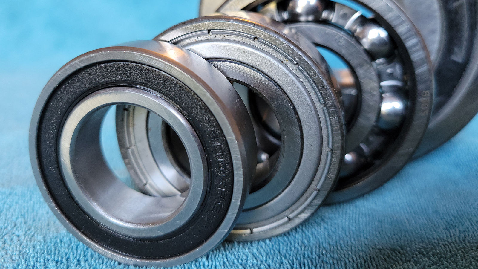

As a simple example, I took four ball bearings in the -05 series: a 6005, a 6205, a 6305 and a 6405. I am not suggesting that a 6005 and 6405 would ever be considered interchangeable. This is just for discussion to highlight the differences and get you thinking about stress and efficiency. In the chart below, the four bearings were loaded onto a shaft in MASTA with an external applied radial load. The clearances and fits were all identical: C3 clearance, K5 shaft and H7 housing. The lubrication was a lightweight ATF run at 70°C in an oil circulation system where splash and churning have little effect (churning can be a big factor in oil bath/splash systems). The graph is expressed in terms of percent efficiency over five different applied radial loads.

I highlighted in red dashes the interesting finding in this test. The largest bearing, by far, is the 6405. As we would expect, at low loads, the 6405 is the least efficient. There is a lot of rotating mass, a lot of sliding and overall friction. An interesting change happens around 5kN of applied radial load. At this point, this is around 25 percent of the static load rating of the 6405 but just over 100 percent of the static load rating of the 6005. The percentage of static load can be loosely thought of as stress on the bearing as 100 percent of the static load rating is intended to reach 4,200 MPa of individual Hertzian roller stress. This clearly shows that as the individual stress increases, efficiency decreases. This is not an intuitive exercise because the bearing load ratings are discreet and this essentially turns into a comparison of step functions. A simple example like this might help you get started off on the right foot. Certainly though, in this exercise, a 6305 showing better efficiency than a 6205 might be a surprising finding.
