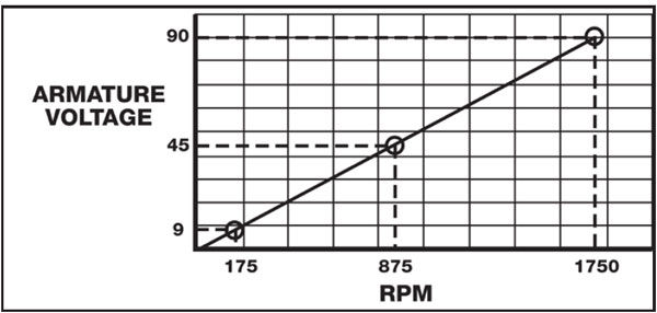

DC motors. Basic DC motors, as used on nearly all packaged drives, have a very simple performance characteristic — the shaft turns at a speed almost directly proportional to the voltage applied to the armature. Figure 1 shows a typical voltage/speed curve for a motor operating from a 115-volt control.
Figure 1 - Typical voltage/speed curve for motor operating from 115 volt control.
Figure 1—Typical voltage/speed curve for motor operating from 115 volt control.
From the above curve you can see that with 9 volts applied to the armature, this motor would be operating at Point 1 and turn at approximately 1,75 RPM. Similarly, with 45 volts applied the motor would be operating at Point 2 on the curve, or 875 RPM. With 90 volts applied, the motor would reach its full speed of 1,750 RPM at Point 3.
From this example a general statement can be made that DC motors have “no load” characteristics that are nearly a perfect match for the curve indicated in Figure 1. However, when operated at a fixed applied voltage, and with a gradually increasing torque load, they exhibit a speed droop (Fig. 2).

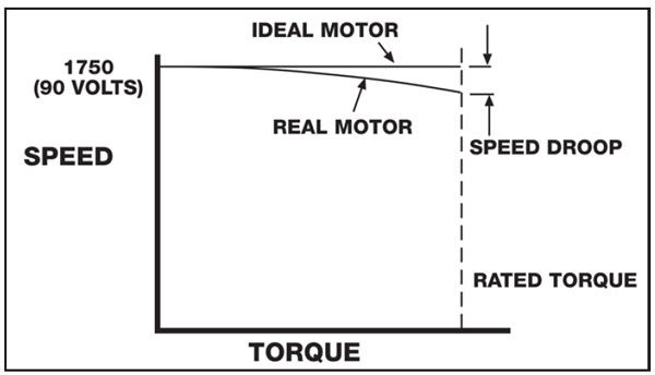

Figure 2 - When operated at a fixed, applied voltage with a gradually increasing torque load, DC motors
exhibit a speed droop.
Figure 2—When operated at a fixed, applied voltage with a gradually increasing torque load, DC motors exhibit a speed droop.
This speed droop is very similar to what would occur if an automobile’s accelerator pedal was held in a fixed position with the car running on level ground. Upon starting up an incline, where more driving torque would be needed, the car would slow down to a speed related to the steepness of the hill. In a real situation, the driver would respond by depressing the accelerator pedal to compensate for the speed loss to maintain a nearly constant speed up the incline.
In the DC drive a similar type of “compensation” is employed in the control to assist in maintaining a nearly constant speed under varying load (torque) conditions. The measurement of this tendency to slow down is called “regulation” and is calculated with the following equation:

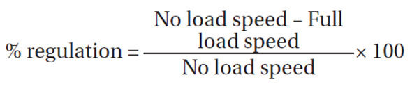

In DC drives the regulation is generally expressed as a percentage of motor base speed.
If the control (regulator) did not have the capability of responding to and compensating for changing motor loads, regulation of typical motors might be as shown in Table 1.
Table 1
DC drive regulation is generally expressed as a percentage of motor base speed; if control (regulator) lacks capability of responding to and compensating for changing motor loads, regulation of typical motors might be as shown in Table 1.

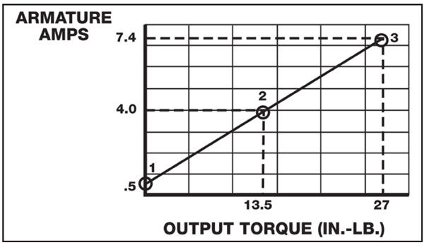

One other very important characteristic of a DC motor should be noted. Armature amperage is almost directly proportional to output torque — regardless of speed; this characteristic is shown in Figure 3. Point 1 indicates that a small, fixed amount of current is required to turn the motor, even when there is no output torque. This is due to the friction of the bearings, electrical losses in the motor materials, and load imposed by the air in the motor (windage).
Beyond Point 1 through Point 2 and 3, the current increases in direct proportion to the torque required by the load.
From this discussion and Figure 3, a general statement can be made that for PM and shunt wound motors, load torque determines armature amperage.
Figure 3 -  Beyond Point 1 and through Points 2 and 3, the current increases in direct proportion to the
torque
Figure 3—Beyond Point 1 and through Points 2 and 3, the current increases in direct proportion to the torque

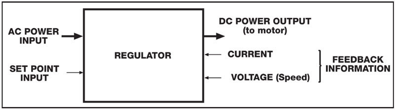

Regulators (controls). The control provides two basic functions:
1. It rectifies AC power, converting it to DC for the DC motor.
2. It controls the DC output voltage and amperage in response to various control and feedback signals, thereby regulating the motor’s performance, both in speed and torque.
Rectifying function. The basic rectifying function of the control is accomplished by a combination of power semiconductors (silicon-controlled rectifiers and diodes) that make up the “power bridge” assembly.
Regulating function. The regulating function is provided by a relatively simple electronic circuit that monitors a number of inputs and sums these signals to produce a so called “error signal.” This error signal is processed and transformed into precisely timed pulses (bursts of electrical energy). These pulses are applied to the gates of the SCRs in the power bridge, thereby regulating the power output to the DC motor.
For most purposes it is not necessary to understand the electronic details of the regulator; however, in order to appreciate the regulator function it is good to understand some of the input signals that are required to give the regulator its capabilities (Fig. 4).
Figure 4 - Input signals required to give regulator its capabilities.
Figure 4—Input signals required to give regulator its capabilities.
The AC-to-DC power flow is a relatively simple, straight through process with the power being converted from AC to DC by the action of the solid-state power devices that form the power bridge assembly.
The input and feedback signals need to be studied in more detail.

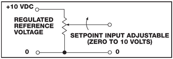

Set point input. In most packaged drives this signal is derived from a closely regulated, fixed- voltage source applied to a potentiometer; 10 volts is a very common reference.
The potentiometer has the capability of accepting the fixed voltage and dividing it down to any value from, for example, 10 to zero volts — depending on where it is set. A 10-volt input to the regulator from the speed adjustment control (potentiometer) corresponds to maximum motor speed; zero volts correspond to zero speed. Similarly, any speed between zero and maximum can be obtained by adjusting the speed control to the appropriate setting.
Speed feedback information. In order to “close the loop” and control motor speed accurately, it is necessary to provide the control with a feedback signal related to motor speed.
The standard method of doing this in a simple control is by monitoring the armature voltage and feeding it back into the regulator for comparison with the input “set point” signal.
When armature voltage becomes high, relative to the set point and established by the speed potentiometer setting, an “error” is detected and the output voltage from the power bridge is reduced to lower the motor’s speed back to the “set point.” Similarly, when the armature voltage drops, an error of opposite polarity is sensed and the control output voltage is automatically increased in an attempt to re-establish the desired speed.
Figure 5 - Set point input signal derived from foxed voltage source.
Figure 5—Set point input signal derived from foxed voltage source.
