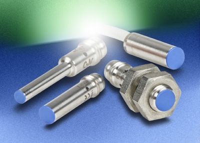

AutomationDirect’s miniature inductive proximity sensors are now available in sizes ranging from 4 mm to 8 mm and feature stainless steel shielded housings. Offered as NPN or PNP models and with normally-open or normally-closed outputs, sensors are available with standard sensing distances of 0.8 mm or 1.5 mm; available extended distance models have either 1.5 mm or 2 mm sensing ranges. The miniature sensors are IP67-rated, are equipped with a 360-degree-visible yellow output LED and come with built-in overload protection. Starting at $16.00, models are offered with an attached 2-meter axial cable or with an M8 connector; axial and right angle zinc-plated mounting brackets are also available for $1.00 each. The new miniature inductive proximity sensors are CE, RoHs and Reach compliant.
