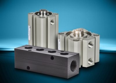

The Nitra Pneumatics H-Series compact extruded body cylinders are offered in bore sizes from 12 mm to 100 mm and stroke lengths from 5 mm to 100 mm to meet a broad range of limited-space applications. The high-quality cylinder bodies and end caps are constructed with hard anodized extruded aluminum and are factory lubricated for optimum performance and long, reliable life. Designed for fittings to be mounted in the top of the cylinder, additional features include a magnetic piston, chrome-plated steel piston rods and slots for mounting 4 mm square cylinder switches. Starting at $19.00, H-series cylinders are interchangeable with other common brands. Also available are aluminum and stainless steel manifolds with 2 to 10 outputs, starting at $8.00, as well as accessories such as rod clevises, male adaptors and rear clevis brackets.
