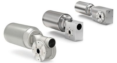

Atlanta Drive Systems, Inc. is pleased to announce a new range of stainless steel washdown gearboxes, perfect for use in demanding applications in the food and beverage, meat and poultry, marine, chemical and pharmaceutical industries. They are ideal for applications that have direct contact with food products which require washdown under high pressure and are available with ATEX and IP69k protection.
They are offered in three levels of corrosion protection depending on the environment they are exposed to: Coated Aluminum (Z-Series), Stainless Steel Shielded (L-Series) and Stainless Steel (I-Series).
The gearboxes are available in reduction ratios from 5:1 to 102:1, with output torque capacities up to 480 lb.ft. and input powers up to 5.4 hp. Stainless steel motors are also available for use with these gearboxes.
Unit design benefits include: housings with smooth surfaces, stainless steel 316L output shafts, viton seals with stainless steel 316L shield, hardened & ground gearing, all stainless steel 316L hardware, closed stainless steel 316L protection cap with o-ring, and fully modular IEC and NEMA C motor flanges.
