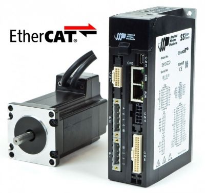

Applied Motion Products recently announced the release of a new series of drives and motors with EtherCAT communications. These new products utilize Applied Motion’s StepSERVO technology which combines the high torque capabilities of step motors with the closed loop dynamic control of servo systems. The result is a motor and drive solution that operates more quietly and efficiently, while providing greater torque and higher acceleration rates than traditional step motor systems.
These newly released StepSERVO Drives and Motors support CANopen over EtherCAT (CoE) control, allowing them to be integrated into new and existing EtherCAT networks. The products support CiA 402 operating modes including Profile Position, Profile Velocity, Profile Torque, Cyclic Synchronous Position, and Cyclic Synchronous Velocity.
