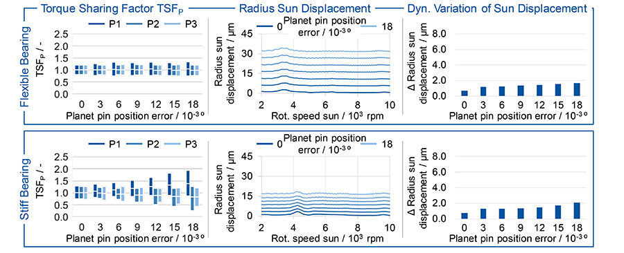

Symmetrical Mesh Sequence. The simulation results for the planet pin position error variation of Planet 1 and symmetrical mesh sequence are shown in Figure 5 and Figure 6. In the case of a flexible sun shaft bearing, the influence of the planet pin position error on the mean torque sharing is only slightly visible, see Figure 5 top left. Planet 1, which is affected by the planet pin position error of φPPE,1 = 0.018°, transmits in average 4.5% more torque with a mean torque sharing factor of TSF1,mean = 1.045 than with an ideal torque sharing. However, the fluctuation range of the torque sharing factors increases significantly up to TSF1,max = 1.277 at maximum planet pin position error. With a stiffer sun shaft bearing, the average torque sharing factor at the first planet is TSF1,mean = 1.375 and the maximum torque sharing factor is TSF1,max = 1.519 in the case of the highest planet pin position error, see Figure 5 bottom left.
Figure 5: Torque sharing and sun displacement with symmetrical mesh sequence.
Figure 6: Sun-planet displacement and operational behavior with symmetrical mesh sequence.
The explanation for the higher torque sharing factors can be found in the comparison of the radial sun displacement, see Figure 5 middle. For an ideal planet pin position, the sun remains in its radial starting position, as expected. In the case of a planet pin position error, the sun shaft performs a circular motion with the rotational speed of the carrier to compensate the deviation. If the planet pin position error is φPPE,1 = 0.009°, a radial deflection with a radius of the sun’s movement takes place in case of the flexible bearing of rdyn,sun,flex ≈ 15.5 μm, whereas a stiff bearing only permits a compensatory movement of up to rdyn,sun,stiff ≈ 7 μm. The lower adjustment movement of the sun shaft leads to higher kinematic constraining forces in case of the stiff bearing, which increases the transmitted torque by the protruding planet 1. The dynamic variation of the radial sun displacement over one revolution of the carrier shows smaller differences between the bearing stiffnesses, see Figure 5 right. The dynamic variation of the sun displacement also increases with an increasing planet pin position error.
The sun shaft does not perform a purely translatory movement in its compensatory movement. Due to the bearings a tilting movement is superimposed. Thus, influences on the rotational misalignment in the tooth contact of the sun-planet-mesh can be expected. In Figure 6, the misalignment components inclination and skew in the tooth contact are converted into a resulting lead angle deviation ƒHβ according to Wittke (Ref. 11). They are shown on the left as bar plot with the minimum, average, and maximum.
Without planet pin position error, all planetary gears have a misalignment in tooth contact of ƒHβ = 7.0 μm. This depends on the tilting moment on the planet gears caused by axial forces and the load-dependent deformation of the carrier. The bar height in Figure 6 on the left represents the dynamic range of the misalignment. With increasing planet pin position error, the misalignment of the individual planets differs significantly. In the contact of the first planet, which is under higher load, the misalignment components inclination and skew compensate each other with a larger planet pin position error, independent of the stiffness of the sun shaft bearing. Since the amount of the sun displacement is different for the flexible and the stiff sun shaft bearings, the compensation also results from a displacement of the planet. Thus it can be concluded that an unbalanced torque sharing leads to a more optimal displacement of the system for the highest loaded planet. Since the mean values of the resulting displacement are less influenced by the stiffness of the sun shaft bearing, higher forces have to be applied to achieve the displacement with a stiff sun shaft bearing. That is the reason for the higher torque sharing factor in Figure 5 and the higher maximum tooth flank pressure in Figure 6. The lower transmitted torque in the two planets without planet pin position error leads accordingly to a maximum tooth flank pressure that is up to 12.4% lower. Here the differences between planet 2 and planet 3 are due to dynamic effects that become visible when evaluating the maximum value.
The first tooth mesh order of the transmission error of the first sun-planet mesh shows a nearly constant excitation in case of a soft sun shaft bearing, whereas the excitation at the second and third planet decreases. In contrast, the excitation with a stiff sun shaft bearing is higher at planet 1 and is constant for the other planets. The transmission error excitation of the first tooth mesh order between the sun and the carrier, which is shown by the dashed shape, is not significantly affected in both cases of bearing stiffness.
In summary, it can be stated that a planet pin position error leads to a significant negative effect on the dynamic torque sharing for a planetary gear-set with symmetrical mesh sequence. A more flexible sun shaft bearing offers the possibility of reducing the maximum torque sharing factors, which has positive effects on the maximum tooth flank pressure and the excitation behavior of sun-planet meshes.
