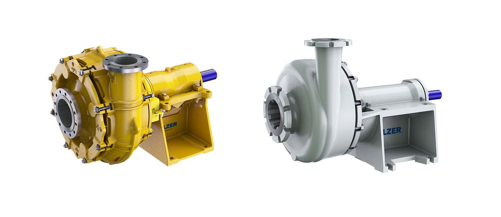

Sulzer2.jpgEMW heavy-duty slurry pump and PLT slurry pump (Courtesy of Sulzer).

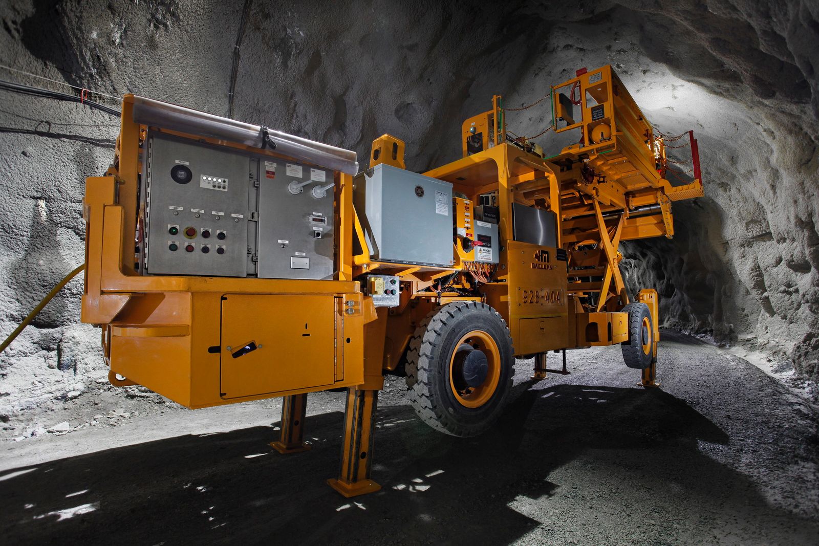

FST_MacLean_975BatteryPower6.jpgMaclean battery-operated equipment for underground mining.
