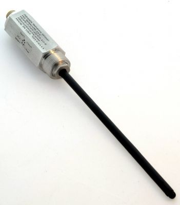

Alliance Sensors Group (a div of H.G. Schaevitz LLC) has expanded its in-cylinder position sensor product line to include the MHP-7 series linear inductive sensors. These compact inductive linear sensors were designed to be installed into the rear endcap of hydraulic cylinders for operation at pressures up to 5,000 psig. Their 1-inch hex aluminum or stainless steel housing are ideal for mobile hydraulics, factory automation machinery, or oil and gas exploration equipment, and mount to the cylinder with a standard male o-ring port thread.

The MHP-7 series sensors are based on a proprietary contactless inductive sensing technology with a short stroke to length ratio. They employ a 7 mm diameter probe inserted into an 8 mm (5/16 inch) gun-drilled hole in the cylinder rod to measure position rather than a ring magnet or pot contact spool. They are offered in ranges from 25 to 600 mm (1 to 24 inches) full scale with a wide variety of on analog I/Os and either connector and cable terminations. The MHP-7 series also includes the MR-7 and ME-7 series for larger cylinders and actuators and the SS-7 for subsea applications.
