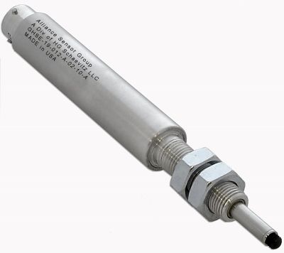

H.G. Schaevitz LLC Alliance Sensors has introduced its GHS-19 series of spring-loaded LVIT (Linear Variable Inductive Transducer) gaging sensors. They are contactless devices designed for dimensional gaging and position measurements in factory automation and in various industrial and commercial applications such as automotive testing, mil/aero test stands, robotic arms, and packaging equipment, where the sensing element cannot be attached to the object being measured. Using LVIT technology with its simple coil design, the GHS-19 series offer excellent stroke-to-length ratios.
GHS-19 sensors have a 0.75 inch (19 mm) diameter aluminum or stainless steel body with a 1/2-20 UNF-2A threaded nose 1.5 inches (38 mm) long and two 0.75 inch (19 mm) hex jam nuts for drop-in installation in place of spring-loaded DC-LVDT gage heads. The sensors’ 0.25 dia. probes are equipped with a No. 9 contact tip, producing a maximum tip force of 1 pound (0.45 kgf). They are offered with a PT02-10-6P. Operating from a variety of DC voltages, these sensors are available with a choice of one of four analog outputs, and they all include ASG’s proprietary SenSet field calibration feature.
