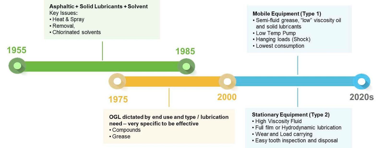

Mining, sugar, paper, textile cement and food production are just some of the applications that utilize OGLs that provide to meet stringent lubrication requirements that include increased base oil kinematic viscosity, high load-carrying, good antiwear properties, pumpability, environmental acceptability, low consumption rates, adequate corrosion protection amongst other secondary requirements (Ref. 3).

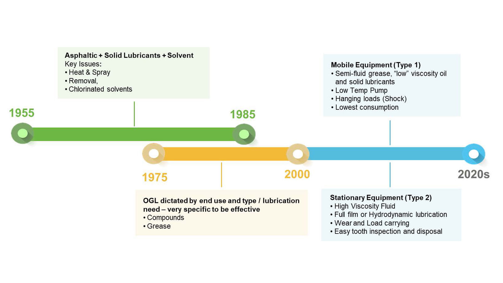

Since industrial applications demand stringent requirements for these lubricants, OGLs have evolved through time since their conception in the 1950s (Figure 1). Since their introduction, the traditionally applied OGLs were asphaltic type products which evolved into sprayable asphaltic cut back products. These OGLs were typically formulated with high kinematic viscosity mineral oils that contained high levels of asphalt or bitumen combined with a volatile solvent diluent.
Figure 1—Evolution of OGLs.

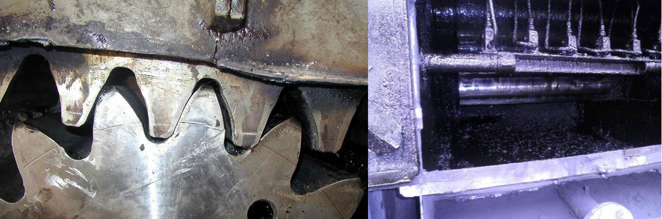

These lubricants were typically applied by spray systems and as the meshing action of gears began, the solvent would evaporate off, leaving behind a viscous lubricant. Cutback solvents were predominantly chlorinated such as 1,1,1-trichloroethane because they were rapid to evaporate, had high flash points and improved the efficacy of spray application. This type of OGL was popular from the 1950s until 1995 when the Montreal Protocol put a global ban on ozone depleting substances in commerce (Ref. 4). These OGLs also caused housekeeping problems because at higher temperatures they would readily oxidize, harden and cause lubricant buildup. At lower temperatures, these lubricants became difficult to dispense and would stiffen, crack and peel-off, leaving gears unprotected (Figure 2).
Figure 2—Asphaltic OGL applied to open gears.

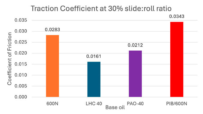

The temperature of 140°C was selected as a severe condition specifically to provide a worst case as a lubricant meshes between gears in field applications. Once each of the samples was loaded into the instrument, their traction coefficient was measured as the slide:roll ratio increased from 0–100 percent. Upon completion, traction coefficients were compared at a single slide:roll ratio and plotted in a bar graph (Figure 3).
Figure 3—Traction coefficient comparison at 30 percent slide.
Based on the base oil screen in Figure 3, it appears that treatment of the Group II 600N oil with polyisobutylene at even low weight percent, had a deleterious effect on the coefficient of friction. Given the OGL markets almost ubiquitous use of PIB as a viscosity improver, it is of no surprise that PIB-based OGL are not top-tier performing base fluids in industrial applications from a thermal perspective. PIBs have higher internal friction because of branching, which causes higher churning loss under fluid film lubrication, hotter running temperatures and lower efficiency. Based on industry knowledge, it was expected that the coefficient of friction would decrease when the PAO was used since it has lower internal friction during usage. Unlike the PAO, it was unclear how the UPP would perform in this study. Based on the results in Figure 3, the UPP provided the lowest coefficient of friction compared to the PAO which suggests that OGLs may see a boost in performance, especially at elevated temperatures, when UPP is used as the base fluid.

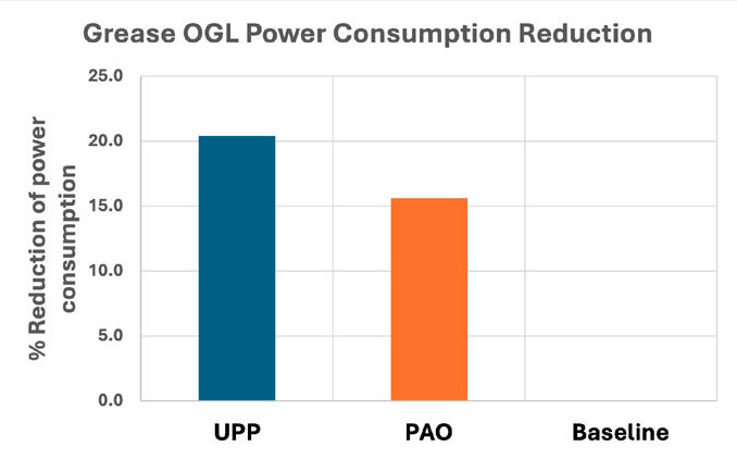

The motor drives on the FZG stands were also capable of outputting the instantaneous power consumed by the motor every 10 seconds. This data can be plotted to form a power curve to illustrate power consumption over the course of the test. Integrating the power curve with respect to time provides the total energy consumed during a given period of time. In this case, trapezoidal integration was used to provide an approximation of the integral using the following equation:
where P is the instantaneous power consumed at the time step shown in the subscript. The energy values can then be compared between samples on a single given stand. This is best expressed as a percentage difference from a given baseline, as this type of analysis is relative to a given stand. The three OGL samples were run consecutively of the same stand and compared to the mineral oil (600N) baseline in Figure 6.
Figure 6—Power Consumption at Load Stage 12.
The results of the testing showed that the UPP based OGL consumed 20 percent less energy compared to the Mineral OGL and 5 percent less energy compared to the PAO OGL. In this comparison, UPP has demonstrated that it provides thermal and power consumption benefits compared to traditional OGL base oils.

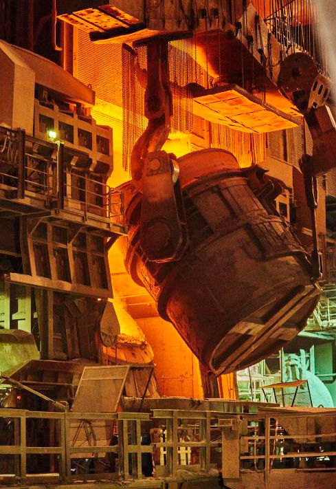

The promising bench testing and mechanical testing allowed us to utilize UPP base OGL in a field trial to see how these grease type OGLs operated in real world, extreme, conditions. The field trial took place at a steel manufacturing facility in Germany. The grease type OGL was applied to the bearings of a casting ladle (Figure 7).
Figure 7—Image of a casting ladle at a steel manufacturer.

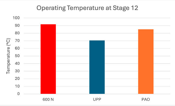

In similar fashion to the Type I OGL studies, FZG testing was also conducted on the Type II fluid OGLs on the same test stand. The test conditions used were specifically for a fluid type—A/8.3/90. All fluids completed 12 load stages without scuffing. The end of test operational temperatures were compared, using the Mineral OGL as the baseline. The results can be seen in Figure 9.
Figure 9—FZG temperature reduction at load stage 12.
The UPP OGL completed load stage 12 at a temperature 15°C cooler compared to the Mineral and the PAO OGLs. The PAO and Mineral OGL seemed to perform identically which is likely due to the similar amounts of PIB needed to achieve their desired viscosities. While this test was being conducted, thermal images were again taken so that the temperature differences could be visualized in Figure 10.

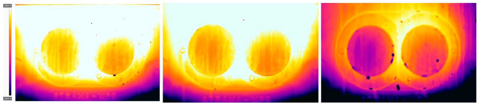

Figure 10—Thermal images of mineral OGL (left), PAO OGL (middle), and UPP OGL (right) at FZG load stage 12.
The color profile of these thermal images is different than the images of the Type I grease OGLs in Figure 5 because a different imaging software was employed. The images show that both the Mineral OGL and PAO OGL run at an elevated temperature in comparison to the gear box running in the UPP fluid OGL. The energy consumption data collected from this testing correlated to the thermal data as well.

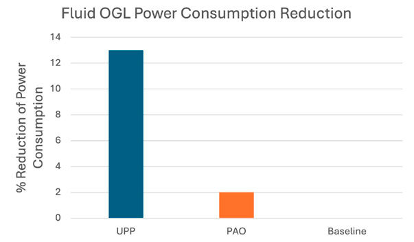

Energy consumption data calculation was executed as indicated in the previous section. The results from the FZG testing found that the UPP OGL consumed 13 percent less energy compared to the Mineral OGL and 11 percent less energy compared to the PAO (Figure 11).
Figure 11—Power consumption reduction at load stage 12.

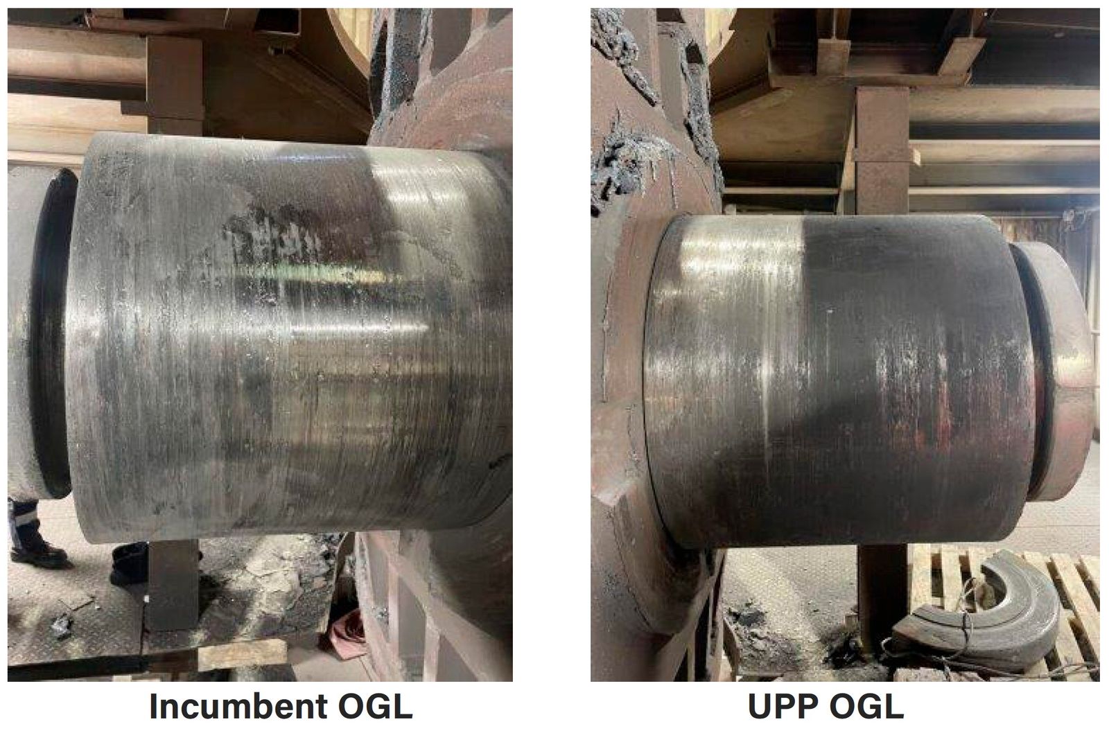

During the field trial, two main parameters were monitored: operating temperature and lubricant consumption. The UPP OGL was evaluated and compared with an incumbent OGL operating on a second mill in the same season and for the same duration of time. At the end of the refining season, the sugar mill reported its overall findings which can be seen in Table 12.
 UPP OGLIncumbent OGL
Average operating temperature, °F74.1 (23.4°C)84.2 (29.0°C)
Set lubrication interval at end of trial18 minutes10 minutes
Bearing appearance at end of trialMinimal wear scarringCatastrophic wear damage
Table 12—Results of sugar mill trial.

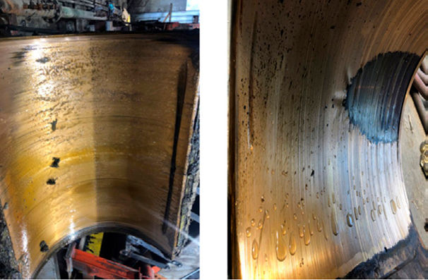

The sugar refinery communicated that the UPP OGL allowed them to reduce the lubrication interval which decreased lubricant consumption by 35 percent. They also reported that the mill with the UPP OGL operated 10°F cooler in comparison to the mill with the incumbent OGL. Lastly, they reported that upon inspection of the journal bearings at the end of the season; the bearing that was lubricated with the UPP OGL could be used for another sugar season. The pictures of the journal bearings at the conclusion of the trial can be seen in Figure 12.
Figure 12—Appearance of journal bearings at the end of trial.

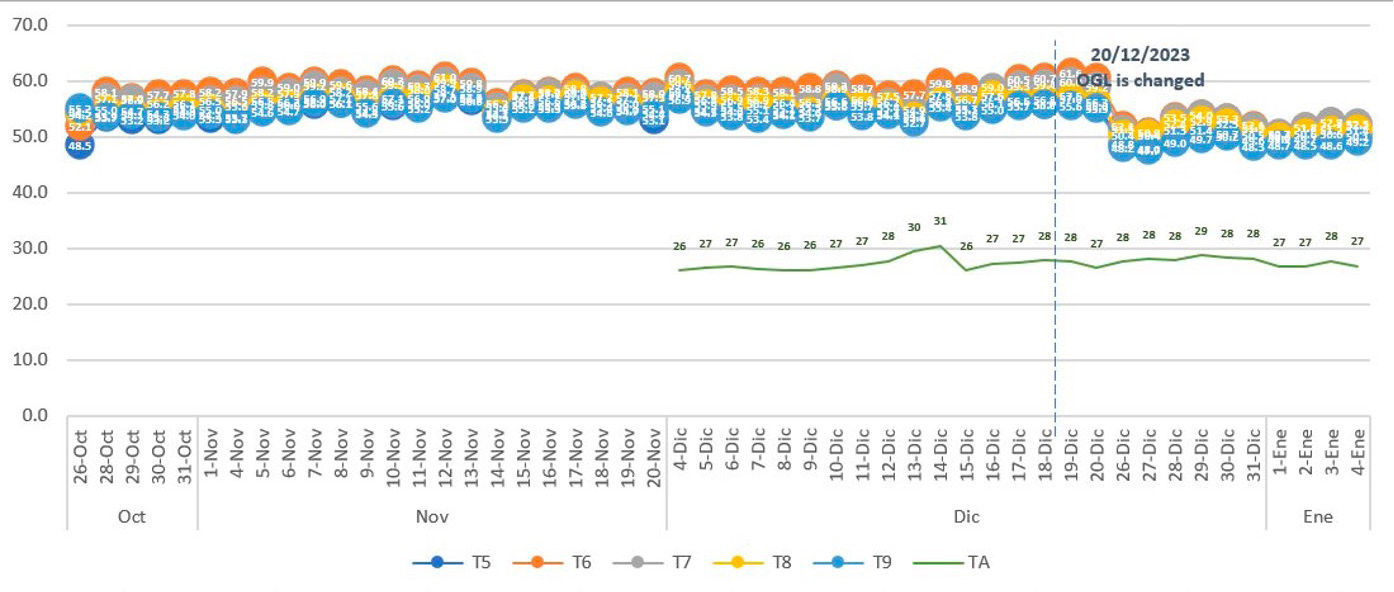

After the successful trial at the sugar refinery, an opportunity to trial at a ball mill presented itself. The ball mills in need of a fluid OGL were located near a copper mine in Peru. The UPP formulation required higher load carry capabilities, so we selected the UPP formulation seen in Table 9. This UPP fluid OGL would be evaluated on two different ball mills. The details of the ball mills can be seen in Table 13.
 Ball Mill 09Ball Mill 10
BrandNorbergCitic Heavy
Size (diameter x length, m)4.27 x 124.27 x 12
Mill speed (r/min)14.615.7
Type of lubrication systemDouble lineprogressive
# of lubrication points76
Table 13—Ball mill characteristics.
Unlike the sugar mill trial, both mills were lubricated with the incumbent OGL and temperature and lubrication consumption were measured. The UPP OGL was then cycled into both mills and the same parameters were monitored. Both mills’ operating temperatures were reduced by 5–6°C. The temperature reduction in ball mill 09 can be seen in Figure 13.
Figure 13—Temperature monitoring of ball mill 09 after introduction of UPP OGL.
This trial is still ongoing, however, the last reports from the mine site have reported that they have reduced the lubrication interval on both mills from 20 minutes to 25 minutes, while maintaining the reduction in operating temperature. The mine site has also reported that they have seen a 9.4 percent reduction in energy consumption on ball mill 09 and a 16.7 percent reduction in energy consumption in ball mill 10. The reduction in energy was based on the energy consumption while the incumbent OGL was in use.
