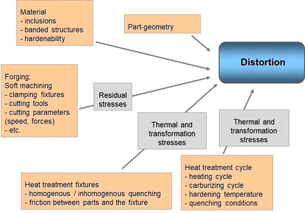

The plastic deformation of metallic components during heat treatment is called distortion. Distortion occurs if the stress in the material exceeds the yield stress of the material. During case hardening the components are exposed to high temperatures ranging from 880°C to 1.050°C and the yield stress decreases strongly with increasing temperature of a component. Three different types of stress in the material need to be distinguished:
  • Residual stresses (they are induced before heat treatment by casting, forging, machining, etc. [Ref. 1]).
  • Thermal stresses (they are caused by the temperature gradient while heating and quenching).
  • Transformation stresses (they are caused by the transformation from ferrite to austenite during heating and transformation from austenite to martensite/bainite during quenching).
These three types of stresses overlay with each other and add up to the total stress in the component. They are influenced by part geometry, steel grade, casting, forging, machining, etc. and they are influenced by heat treatment. If the total stress in the component exceeds the yield stress, then plastic deformation (distortion) of the component takes place. The chronology and the height of the three types of stresses leading to distortion are dependent on numerous influencing factors, see Figure 1.

Figure 1—Factors influencing distortion.

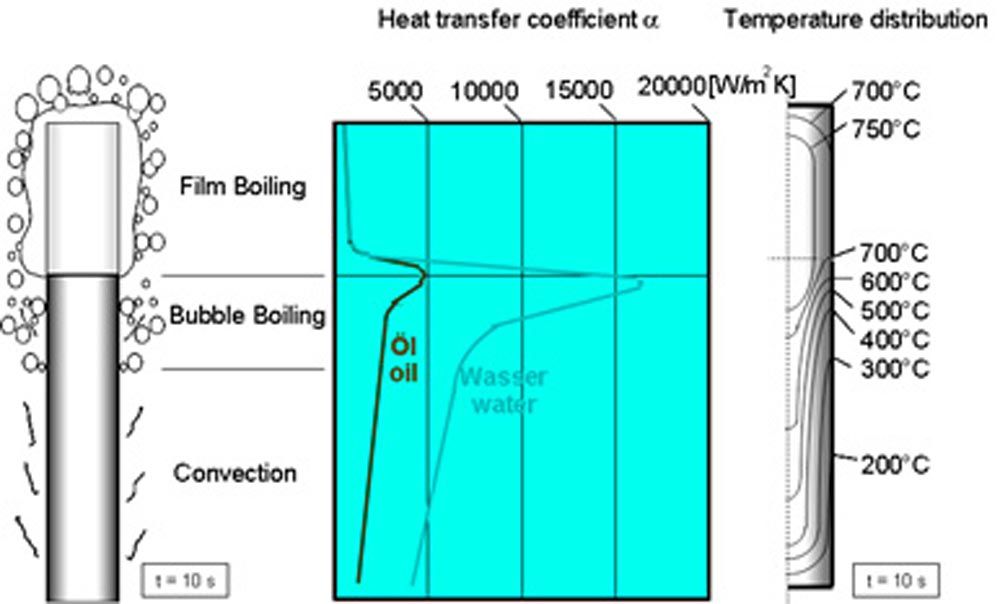

Heat treatment distortion can be significantly reduced by applying the technology of Low-Pressure Carburizing (LPC) and High-Pressure Gas Quenching (HPGQ). LPC is a case-hardening process performed at a pressure of only a few millibars using acetylene as the carbon source. During HPGQ the load is quenched using an inert gas stream instead of a liquid quenching media. Usually, nitrogen or helium are used as quench gas (Refs. 2, 3, 4).
HPGQ offers significant potential to reduce heat treatment distortion. Conventional quenching technologies such as oil or polymer quenching exhibit nonhomogeneous cooling conditions. Three different mechanisms occur during conventional liquid quenching: film-boiling, bubble-boiling, and convection. Resulting from these three mechanisms, the distribution of the local heat transfer coefficients on the surface of the component is very nonhomogeneous. These nonhomogeneous cooling conditions cause high thermal and transformation stresses in the component and subsequently distortion. During HPGQ only convection takes place which results in much more homogenous cooling-conditions, see Figure 2 (Refs. 5, 6). Significant reductions of distortion by substituting Oil-quench with HPGQ have been published (Refs. 7, 8).
Another advantage of HPGQ is the possibility to adjust the quench intensity exactly to the needed severity by choosing quench pressure and quench velocity. Typical quench pressures range from 2 bar to 20 bar. The gas velocity is controlled by a frequency converter. Typical gas velocities range from 2 m/s to 20 m/s. Quench pressure and gas velocity are chosen depending on the part geometry and the steel grade of the component to achieve optimum results.
Figure 2—Heat transfer coefficient and temperature-distribution in liquid- and gas-quenching (Ref. 5).
The following equation describes the heat transfer coefficient as a function of gas velocity, density, and type (Ref. 2).
