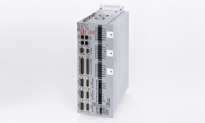

ACS Motion Control has released its SPiiPlusCMxa, the latest product in its SPiiPlus series of EtherCAT-based master motion controllers. Suitable for applications with micron to nanometer resolutions and demanding velocity control requirements, this device includes up to three integrated motor drives that leverage powerful servo control algorithms to maximize motion system performance. It is also configurable to control up to 64 axes.
The CMxa integrates universal motor and encoder technology, enabling system designers to control any type of motor or stage. Its fixed servo sampling and update rate provides the tightly synchronized, real-time control required for sophisticated multi-axis machine designs.
Designed as a drop-in replacement for SPiiPlusCMba and SPiiPlusCMhp motion controllers, the CMxa is supported by ACS Motion Control’s SPiiPlus ADK Suite, which contains many advanced servo tuning and application development tools. Common applications include metrology, inspection, alignment, laser micromachining and other industrial applications.
