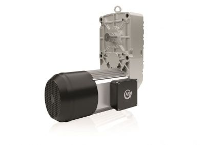

Many mid-size crane manufacturers bank on complete hoist drive technology solutions from ABM Greiffenberger. These drives are specifically developed for this market segment and characterized by a high degree of functionality. With the new GHX-Series the systems provider has now developed new powerful and energy efficient hoist gear drives with outstanding overall energy efficiency. In addition new angular travel drives provide a new option for crane builders.
Compared to previous hoist gear drives, the new series expand the possible range of use with larger center to center distances. The new GHX 63 allows the installation of wire rope drums with a diameter of up to 270 mm and the GHX 125 even up to 325 mm increasing the design flexibility for crane builders. Another benefit on inverter operated hoists is the possibility to increase the no-load lifting speed up to 200 Hertz substantially reducing cycle-times. On two speed hoist motors ABM further optimized the speed change behavior reducing operating noise. The GHX-Series hoist drives are designed to meet FEM 2 m resulting in doubling their service life. A further new hoist drive type GHX-250 with load capacities of up to 25 metric tons is currently under development.
Thanks to aluminum housings the hoist drives are light weight and highly corrosion resistant. Complete gearbox-motor-brake units can easily be mounted to the hoist frame. U-shaped cable drum set-up provides space saving mounting and enables a compact wire rope design to state of the art criteria. Numerous options and protection classes are available and provide maximum flexibility to adapt to crane builder’s requirements. As an example available auxiliary electrical fans and encoders complement a hoist drive unit for inverter operation.
