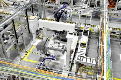

The ABB FCHA design improves upon traditional serial assembly systems by allowing multiple cylinder head architectures to be assembled simultaneously, without the need for time consuming and production halting changeovers. The technology provides a modular and flexible platform based on parallel processing, minimizing, and in many instances eliminating, the use of dedicated stations. This incorporates redundancy for critical operations, and allows production volumes to be easily adjusted as required.
“Collaborating with Ford on this project has been very rewarding. Nobody else has this technology,” said Isaac Zolotarev, R&D manager, ABB Robotics. “With a very competitive initial investment, we can provide a system that reduces tooling costs and the time required to launch new architectures, while improving product quality and reducing the system footprint. It is a very significant accomplishment in cost effective flexibility and performance.”
A complete FCHA system features 15 ABB robots, comprised of four different medium and high payload 6-axis models. Certain modules within the system can be integrated into existing, traditional cylinder head assembly stations, such as installation of plugs, sealer dispensing, valvetrain assembly and test.
Additional FCHA system features include: force and distance monitoring for valve assembly and key up processes prevents damage of delicate components; integrated key up checks at point of assembly; loctite/sealer dispensing with a single nozzle for any size holes; and integrated quality checks throughout the assembly process.
Ford has designated the system as an internal Bill of Process (BOP), establishing it as the new design standard for all cylinder head assembly lines installed at Ford engine manufacturing systems.
