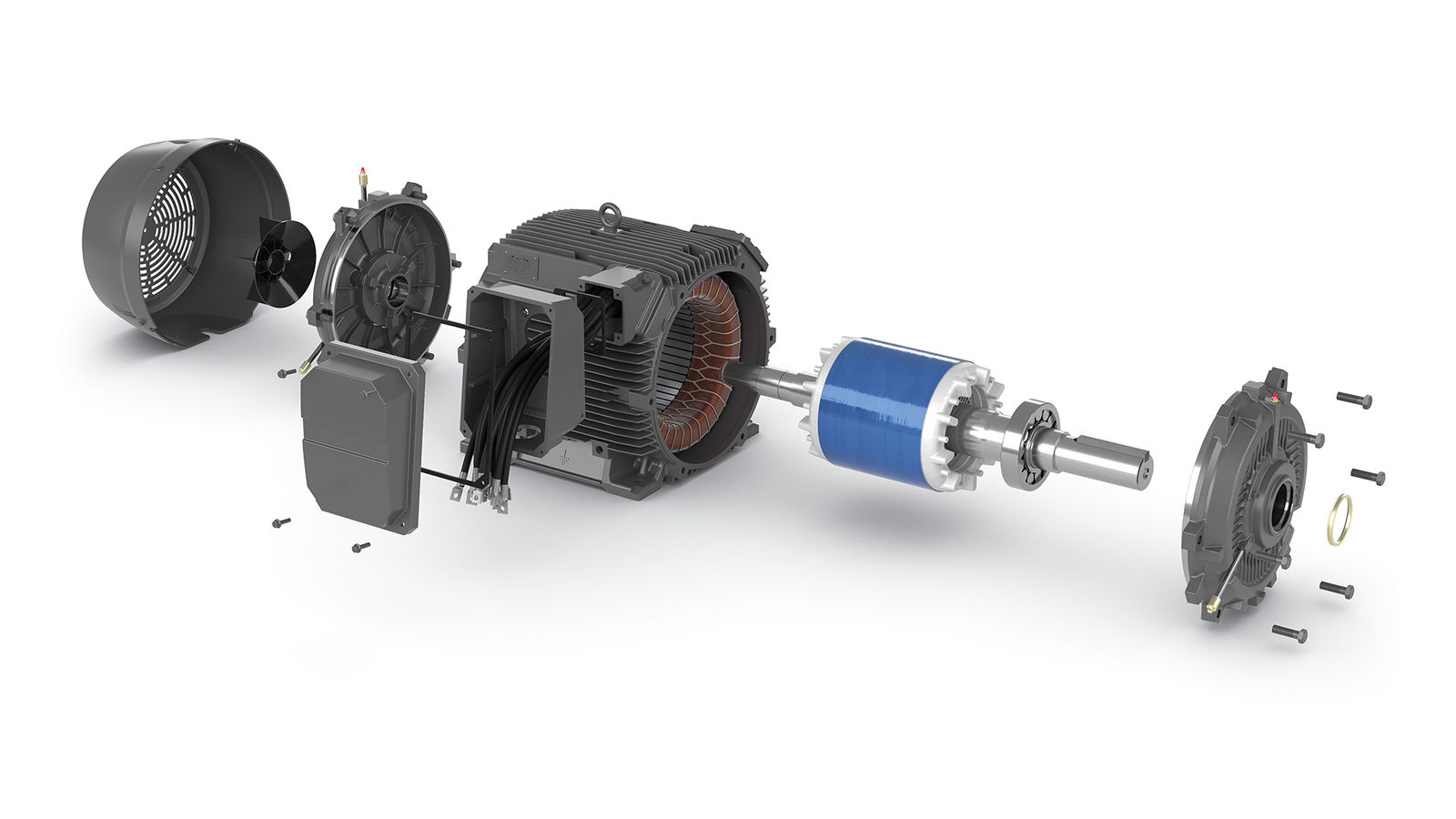

Built on ABB's SD200 severe-duty platform, the motor features heavy-duty cast iron frames, C-4140 high-strength steel shafts, Class H insulation systems and IP55 ingress protection for demanding environments, including mining, chemical processing, petroleum refining, pulp and paper, water and wastewater.
SD200 SP4 combines NEMA Design B performance with rugged severe-duty construction to increase energy performance without compromising reliability, ABB said. It reduces motor losses by an average of 20 percent, lowering electricity consumption in continuously running applications. SD200 SP4’s reduced heat generation also supports cooler operation, longer service intervals and dependable long-term operation.
ABB’s SD200 SP4 is fully frame-by-frame compatible with existing SD200 motors, so operators can replace motors without costly equipment redesigns. Drop-in compatibility streamlines specification, installation and maintenance, while an oversized conduit box wiring access and serviceability.
