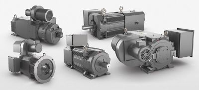

When space is at a premium, ABB’s Baldor-Reliance RPM AC motors deliver the highest levels of performance. RPM AC is designed with a power-dense laminated steel frame with custom power and speed ratings to match demanding variable speed application requirements.
From their introduction more than 30 years, RPM AC induction motors have stood the test of time, representing the best in high-performance, power-dense, true variable speed motors. Since then, RPM AC has evolved into one of the broadest variable speed AC motor offerings available. From 1HP to 1750HP, with customizable speed ranges in nearly any enclosure type, RPM AC is designed to handle the most difficult and demanding applications in industries such as chemical, oil and gas; plastics; HVAC; energy; forest products; metals and industrial automation.
The RPM AC motor is optimized for adjustable frequency service - not just a re-rate or over framing of a standard motor. All RPM AC motors are designed to provide continuous constant torque from base speed down to and including zero speed, and - unlike conventional sine wave motors - this means that the RPM AC motor will generate full rated torque, run continuously and not overheat at any speed below base speed. Above base speed, RPM AC produces constant horsepower up to its maximum capabilities.
With Generation 3, RPM AC raises the bar yet again. The power range has been extended, grounding provisions are now standard, setup and deployment are easier than ever and, when combined with optional ABB Ability smart sensor technology, connectivity and data analytics can be accessed by users and technicians onsite or remotely.
Gen 3 also introduces the web-based RPM AC Wizard, a new tool that allows customers to design a motor that best satisfies unique application requirements. Enter horsepower, base speed, top speed and overload requirements, and the Wizard designs a custom motor and full-load current rating that best fulfills the need of the specific application and industry. Another click produces complete electrical design curves, performance data and dimension sheets. RPM AC Wizard is a true motor design tool, not just a table look up program.
