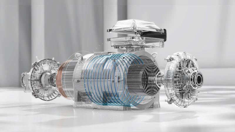

ABB has launched a new version of its IE5 SynRM (synchronous reluctance motor) that combines the benefits of ultra-premium energy efficiency with highly effective liquid cooling. The new design sets a new benchmark for high power output and reliability in a compact footprint.
Customers can use IE5 SynRM Liquid-cooled motors to save energy costs and cut emissions in new projects or as a drop-in replacement for less efficient motors. They are ideally suited to a wide range of industries including marine propulsion, rubber and plastics production, and food and beverage.
A major advantage of the IE5 SynRM Liquid-cooled motors is that they are much more efficient than the traditional liquid-cooled induction motors in current use that offer significant potential for upgrading with energy-saving technology. Energy efficiency is crucial to optimizing the total cost of ownership (TCO) of an electric motor because the cost of the energy to run it throughout its life accounts for around 97 percent of a motor’s TCO, with the purchase cost accounting for about two percent. IE5 motors have 40 percent lower energy losses than commonly used IE3 motors. This makes the payback time for selecting an IE5 instead of an IE3 motor often less than one year.
Reliability is improved by highly effective cooling combined with the cool SynRM rotor and cooling ribs on the bearing assembly that reduces the operating temperature of the bearings. This helps to increase the lifetime of this key component and reduce maintenance needs.
The motors are robust, with tight seals to keep out moisture, dirt and dust, and a smooth outer surface to prevent dust build-up. This makes them perfect for demanding applications that require high power density where space is restricted such as marine propulsion systems and thrusters. Furthermore, the motors do not need fans or ventilation, so they do not disturb the surrounding air or release heat into the local environment. This is a major benefit in processes that are impacted by airflow, such as rubber and plastics production, and food and beverage applications like chocolate conche machines. With no fans, the motors also enhance the working environment by reducing noise levels.
