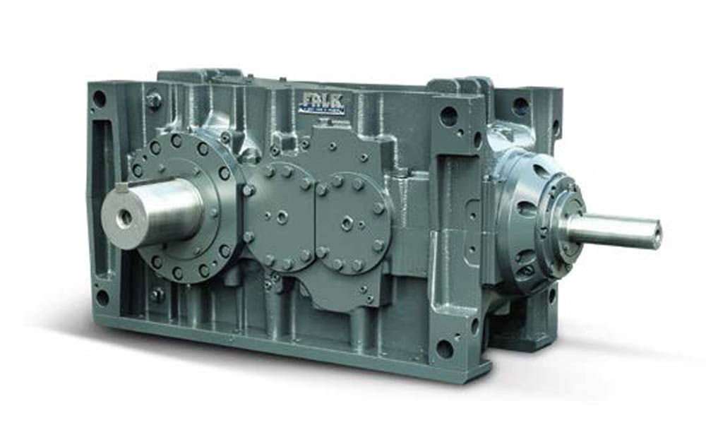

The Falk V-Class gear drive offers cooler operating temperatures, optimal power and advanced technology.

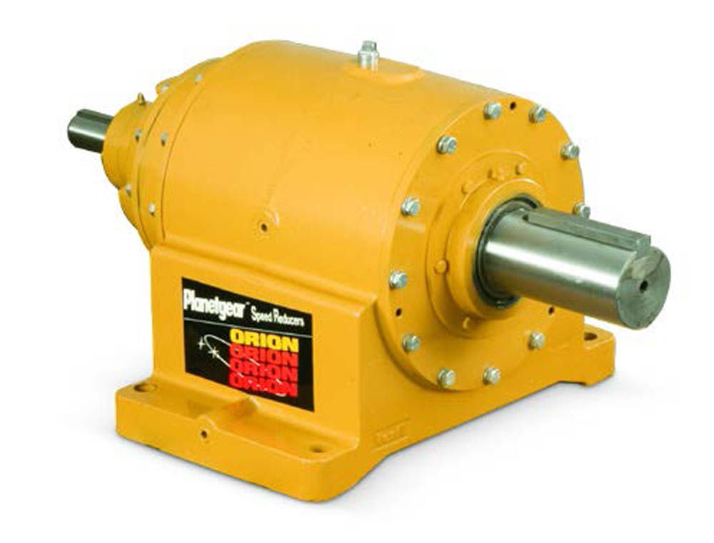

Rexnord PlanetGear gear drives rugged design are proven to meet the operating challenges of the world's most demanding applications.
