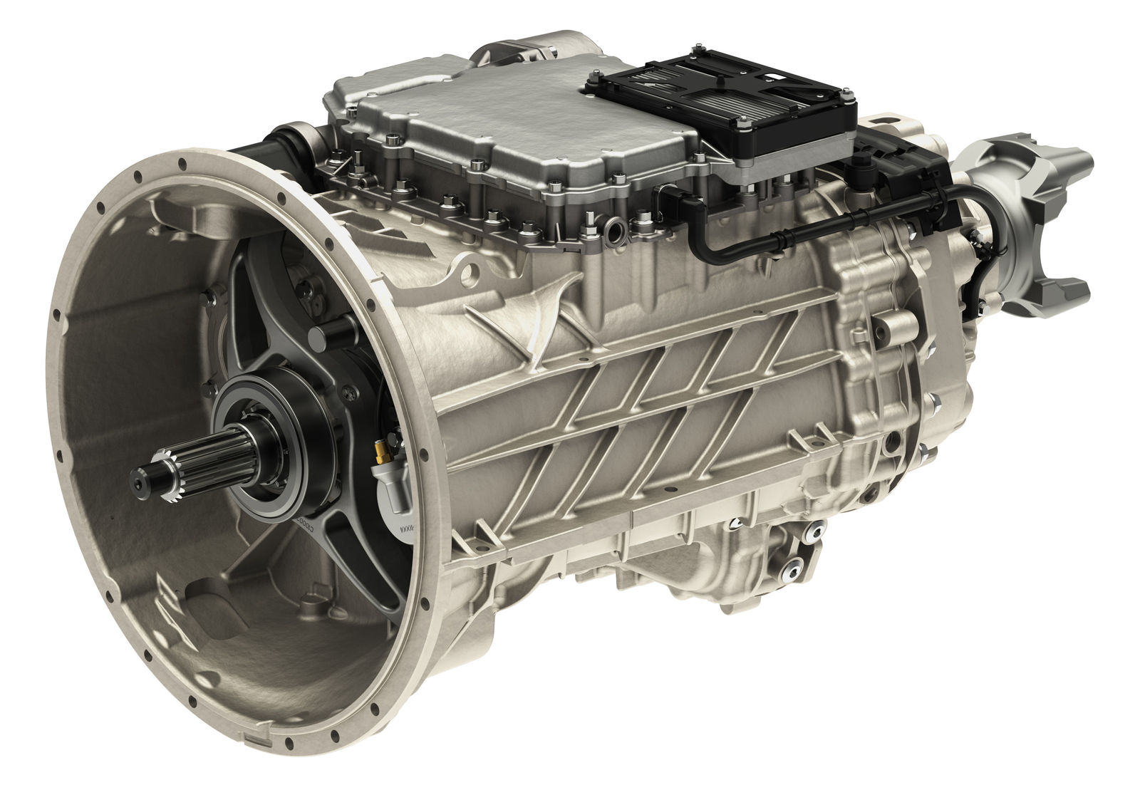

Eaton Cummins Releases Endurant XD Series for On-Highway Applications
Matthew Jaster, Senior Editor
Eaton Cummins Automated Transmission Technologies recently released specifications for its new Endurant XD series and announced it will include Endurant XD and Endurant XD Pro models.
The Endurant XD series are purpose-built, high-performance automated transmissions designed for on-highway applications with high gross combined weight ratings, such as double and triple trailer trucks, and severe-duty on/off highway applications like dump and logging trucks.
“Purpose-built means designed from the ground up—from the gear architecture to the shifting to the actuation. It is all meant to be an automated transmission. There’s no manual version, it’s not human shiftable,” said Ken Rocker, Endurant XD series product manager, Eaton Cummins Automated Transmission Technologies. “This opens up changes to improve the shift qualities as well as the introduction of a new ratio gearset.”
The Endurant XD series features a twin-countershaft design with helical gearing and large bearings optimized for higher engine torque. A new 18D ratio set with 20.5:1 overall ratio with small, even steps ensure smooth shifts and performance benefits in all driving conditions. It is packaged in a clean, contained design with internal wiring and sensors to minimize exposure and corrosion for improved reliability. Overall, its design is 225 pounds lighter than comparable UltraShift PLUS models.
This article appeared in the March 2022 issue.
“One of the major differences between this gearbox set—a three by three by two architecture—is that there’s one less gear layer in this transmission compared to the legacy 18-speed models. There are less gears in this transmission, but we still achieve 18-speeds,” Rocker said. “Some of the weight savings came from fewer components and a large savings came from the all-aluminum enclosures as opposed to cast iron. We’ve also gone from a twin-plate clutch to a single-plate clutch, so additional weight was removed.”
Twin countershaft technology is all about balancing the thrust and loading of the forces as you distribute the torque across the gear meshes, according to Rocker. “Splitting the torque in both directions keeps everything in balance and cancels out some of the thrust loadings you would typically have to account for in your bearing, gear and shaft design,” he added.
A new, input shaft driven Power Takeoff (PTO) system delivers power to an 8-bolt bottom mount and 4-bolt rear mount that can operate independently of the transmission gear. The 4-bolt rear mount features an external pressurized lube port and a large center distance, making it an ideal alternative when there is no room for a bottom mount PTO. Total combined PTO capacity is 160 hp or 610 lb.-ft. of torque.
Fuel and maintenance are two of the largest expenses for a trucking operation.
One of the big improvements is that the clutch is self-adjusting, maintenance-free, greased for life, so there is no maintenance. The efficient design features a Precision Lubrication system for up to two percent better fuel economy than UltraShift PLUS. Additionally, smart features such as new internal oil temperature and fluid pressure sensors help protect the transmission from damage.
“The new gear architecture layout improves fuel economy so now the most efficient gears are in the top half of the gearbox, above 20–25 mph, you’ll be in more efficient gear paths,” Rocker added.
Trucks operating below 110,000 pounds do not require a transmission cooler, reducing the risk of cooler leaks. Maintenance costs are minimized thanks to long service intervals — up to 500,000 miles depending on vehicle application — and help keep the truck on the road and making money.
New for the Endurant XD series are Performance Goals, which combine transmission shift points and clutch calibrations with unique software. This allows operators to easily tailor transmission performance to the demands of the job.
“This used to be called shift calibration and they’re made up of shift maps or shift points specific to the targeted activity (i.e., performance and economy) but they also contain clutch calibration characteristics (control, smooth or aggressive clutch closure rates) and the third piece is specific software algorithms that we use to adapt the shifting. We can monitor how quickly the transmission adapts and changes to the environment,” Rocker said.
Endurant XD is rated for engines with a maximum torque rating of 1,650 to 1,850 lb.-ft. and is designed for on-highway applications up to 166,000 pounds Gross Combined Weight Rating (GCWR).
Endurant XD Pro utilizes Eaton’s Extreme Duty clutches, which feature robust components designed for increased durability, improved noise, and vibration, in addition to higher thermal capacity for enhanced low-speed maneuverability.
Unique software features to the Endurant XD Pro include Rock Free, which helps avoid getting stuck in sand, mud, or snow by using the accelerator to rock the vehicle free, and the Off-highway Performance Goal, which is an optimized calibration for operation on natural rolling terrain and soft soil.
“Endurant XD Pro has the right mix of hardware and intelligence to give drivers more confidence in the most challenging applications such as construction, heavy haul, towing/ recovery, and logging,” Rocker said.
Production of the Endurant XD series begins in Q3 2022. Truck manufacturers are expected to announce availability of Endurant XD series at a later date.

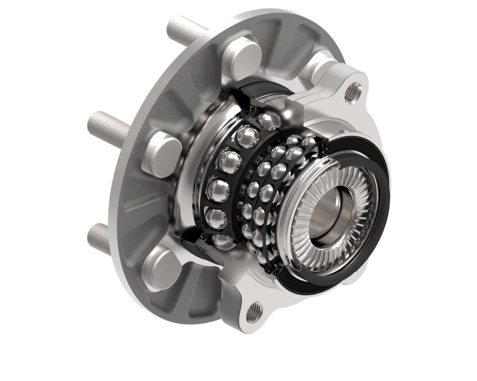

Schaeffler TriFinity Wheel Bearing Provides e-Mobility Solution
Schaeffler’s TriFinity wheel bearing is a fully optimized, three-row, angular contact ball bearing that provides higher stiffness and longer service life by minimizing friction and mass.
TriFinity.jpg“Generally, when we look at wheel bearings, we’re looking for solutions that provide higher load carrying capacity,” said Michael Eastman, Director of BU Wheel Modules for the Americas at Schaeffler. “We’ve been working on high-capacity density solutions for years. How can you provide more life to the bearing in a smaller package?”
This occurs through material selection, bearing design, etc. Over the last three years, Schaeffler took this concept and focused on friction reduction with an eye on the battery electric vehicle (BEV) market. The North American market is focused on larger electric vehicles, so the Schaeffler team thought it made sense to find a lower friction solution to the standard bearings produced today.
A Closer Look at Wheel Bearings
“There are two different types of wheel bearings—ball bearing and tapered hub units. They are typically two row bearings. The tapered hub units have typically been used on trucks,” Eastman said. “We wanted to produce an electric market solution for trucks and SUVs that was really able to bring the rolling resistance down. Along with these benefits, the TriFinity wheel bearing can improve camber stiffness and while meeting life requirements for the application as well.”
The TriFinity wheel bearing can get friction down around 50 percent compared to a tapered hub unit. It can also provide a downsizing solution when a customer is designing a new BEV and the bearing needs a little more capacity.
“If you have a smaller package, your friction is going to be smaller because your seals and your rolling elements are all operating on a smaller diameter. So, we can get decent friction improvements there—somewhere between eight and 20 percent with the downsizing solution,” Eastman added.
While the concept of the TriFinity wheel bearing was created with BEVs in mind, it’s also translatable to ICE vehicles as well.
“We’ve done some similar vehicle level testing in the past. If you take an existing tapered hub unit and replace it with the TriFinity wheel bearing on all four wheels, based on our data we’d expect a one to two percent improvement in fuel economy. It all depends on the motivation of the customer,” Eastman said.
For monitoring purposes, wheel bearings typically use ABS encoders. The wheel speed encoders are integrated.
“Down the road for autonomous vehicles—Level 5, people mover applications—condition monitoring might be something we have to think about because the vehicle needs to know the operating conditions of the components and the wheel bearing is one of them,” Eastman said. “Once these vehicles become more prevalent in the market, we’ll look closer at these technologies.”
Additional Technology
Usually, forces are transferred between the drive shaft and wheel hub via a radial spline. To meet vehicle manufacturer’s growing CO2 reduction requirements and address NVH issues with the radial spline design, a new transfer variant was developed by Schaeffler known as face spline.
The face spline is positioned axially on the half-shaft and at the transmission-side end of the wheel hub. During wheel bearing production, the orbitally formed shoulder and face spline are made in a single step.
“When you look at the BEV market two things come to mind: The vehicles are heavy and they have high torque,” Eastman said. “Face spline gives us the ability to integrate the technology into the TriFinity wheel bearing and hit both of those marks. We can not only manage the loads but also addresses the needs on the torque side.”
Friction benefits happen at the component level, but at the system level it translates into range extension and fuel economy improvements for ICE engines.
Future Considerations
Schaeffler is looking at other improvements to reduce friction and increase life. Some of those areas involve seal development advancement and grease technology.
“Sensor integration is another focus area,” Eastman said. “What type of sensor integration do we need? What type of condition monitoring systems do we need? We’re collaborating with our colleagues to answer those questions.”
The TriFinity wheel bearing will go into production toward the end of 2022 or early 2023. Visit the PTE website to learn more about this and other e-Mobility solutions.
