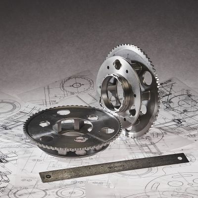

The Grand Prize in the Automotive—Transmission Category was awarded to GKN Sinter Metals, Auburn Hills, Michigan, for a planetary carrier assembly made for Ford Motor Company. The sinter-brazed copper-steel assembly, comprised of a cage and a flanged hub, goes into the all-new 10-speed transmission for the Ford F-150 pickup. The finished carrier assembly requires only simple milling and turning operations to hold the tight tolerances on the bearing bores, pinion pin shaft holes, and thrust faces.

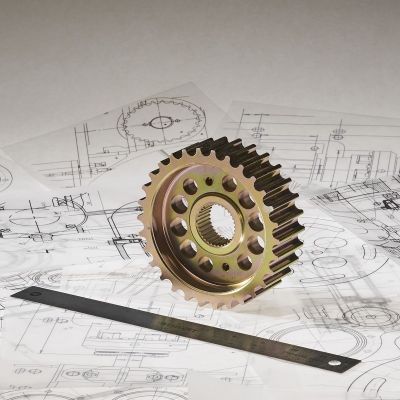

The Grand Prize in the Hand Tools/Recreation Category went to FMS Corporation, Minneapolis, Minnesota, for a 30-tooth drive sprocket fabricated from sinter-hardened steel with a proprietary machining additive, made for Polaris Industries, Inc. The part goes into a motorcycle where it is driven by the output shaft of the transmission and in turn drives the rear wheel via a toothed pulley. Other than tapping, the part is formed completely net shape, which offered cost savings over the previously machined part.
