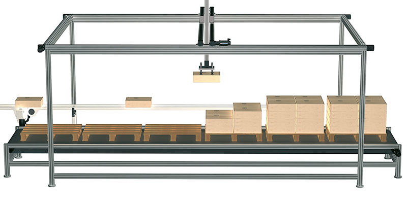

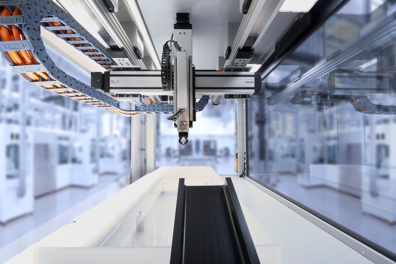

Consider linear module mounting and integration into larger machines.
Linear modules are often integrated into larger machines or combined into systems such as pick-and-place Cartesian robots. One item often overlooked is the module connection and mounting. Depending on the supplier, some modules are designed to be mounted only by the base of the extrusion; if the mounting location on the machine doesn't allow for that, additional mounting brackets and other hardware may have to be purchased or machined from scratch, increasing costs and adding time to machine integration.
Be sure to investigate how a linear module will be mounted and evaluate mounting options. In addition, check if features are included to help fit and align modules quickly and accurately into tight machine spaces. Standardized, positive-locking connection elements with centering technology alleviate the need for expensive, custom-designed construction. Bosch Rexroth linear module components, for example, feature connecting elements, such as brackets, adapter plates, clamping fixtures, sliding blocks, T-nuts, positive-locking centering rings, etc., designed to simplify installation and integration.

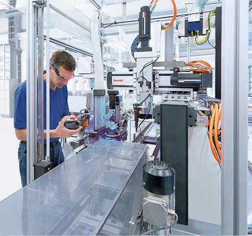

Use linear modules that have been fully tested to ensure proper mounting and alignment.
Incorrect mounting and alignment practices can degrade linear module performance, with components like bearings and belt drives wearing out faster than expected. Work with a linear module supplier whose products are engineered with centering technology, such as centering holes and slots for connectivity, which helps to ensure that all components are tightly aligned and level as part of the installation process.
It's also important to ask about the type of performance testing a linear supplier conducts on its products. Some suppliers assemble and deliver customers' modules without testing first, leading to specification issues after the install. It's best to work with a supplier that performs a runoff test with torque measurement, verifying that when the linear module is manufactured, it meets all specifications.
