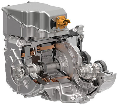

Schaeffler
Starts Mass Production of Electric Motors
Schaeffler is now reaping the rewards of its decision to create a specific business division for electric mobility three years ago, at the beginning of 2018. The start of mass production for multiple products across all electrification levels is testimony to Schaeffler’s successful engagement in the electric mobility arena and to its status as the technology partner for advancing how the world moves.
“We have successfully transformed ourselves into a drive system supplier for sustainable electric mobility solutions and established ourselves as a reliable partner for our customers,” says Matthias Zink, CEO Automotive Technologies at Schaeffler AG. Schaeffler’s key point of difference is its know-how on components and system levels. “We have been engaged with electric mobility for more than 20 years and we understand the drive train requirements. Our innovation capacity as a global automotive and industrial supplier plus our strong industrial skills make us a preferred partner for our customers.”
Over the last few years, Schaeffler has progressively strengthened its electric mobility expertise through a series of targeted acquisitions. The purchase of Elmotec Statomat at the end of 2018 added new expertise in winding technology, providing Schaeffler with comprehensive coverage of all aspects of electric motor industrialization. Another highly successful acquisition back in 2016 was the takeover of Compact Dynamics, a specialist in the development of innovative electric drive concepts. Meanwhile, the Schaeffler Paravan Technologie joint venture is developing the Space Drive steer-by-wire system, a key technology for autonomous driving.
Mass production solutions across all levels of electrification
Schaeffler supplies technologies for all electrified drive trains. Mass production of the electric axle transmission, a key component of electric axle systems, has been running successfully since 2017, providing optimum transmission ratios and power transfer from the electric motor to the wheels. This is a highly versatile component with a wide range of applications. In the Audi e-tron, for example, Schaeffler electric axle transmissions, with different structural designs, are used on both axles for all-wheel drive capability. And the Porsche Taycan is fitted with a high-efficiency Schaeffler coaxial electric axle transmission to provide the required transmission ratio on the front axle. In 2020, the coaxial electric axle transmission earned Schaeffler the prestigious PACE Award, regarded by the industry worldwide as the hallmark for successful automotive projects. Schaeffler has also secured multiple orders for its complete “3in1 electric axles”, which combine the electric motor, drive unit and power electronics in a single system. These are high-performance electric axles with advanced power density.
Electric motors: Start of mass production
This article appeared in the March 2021 issue.
This year will see the start of the mass production of hybrid modules, hybrid drive units and all-electric axle transmissions. The basis of Schaeffler’s electric motor production is a modular, highly integrated technology platform. Schaeffler’s strong expertise in the areas of production and technology across all components of electric drive systems is the key to the successful industrialization of products that are both technologically advanced and highly profitable. Along with a series of mass production orders for electric motors in the passenger car sector, Schaeffler has recently reached another milestone by entering the heavy-duty applications segment for commercial vehicles. Schaeffler has announced a mass production order for electric motors featuring wave winding technology, a technology that provides high power density as well as advantages during assembly.
Record order for dedicated hybrid drives
As reported last year, Schaeffler has received a record order for dedicated hybrid drives. From 2024, Schaeffler will deliver an entire drive unit comprising two electric motors and transmission with integrated power electronics. A system power rating of 120 kW offers sports-car like performance with low fuel consumption. “We are making excellent progress,” says Dr. Jochen Schröder, president of the E-Mobility business division. “Our modular product portfolio enables us to offer customized volume-production solutions to meet any customer requirement,” Dr. Schröder continues. These successes in the E-Mobility business division reflect the company’s high standing as an automotive and industrial supplier in general. Schaeffler is a component, system and service supplier, as its comprehensive product portfolio illustrates.

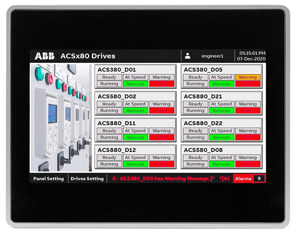

HMI and Drive Faceplates Provide Comprehensive Views into Automation Systems
The CP600 Gen2 HMI with Drive Faceplates provides a NEMA 4X rating, brighter screens, additional communication ports and integral web server capability with faceplates to expand and customize operator views.
ABB’s CP600 Gen 2 HMIs offer NEMA 4X rating, an expanded temperature range, 33% brighter screens, additional communications ports and integral web server capability, allowing users to expand HMI usage into more applications. Available in 7", 10' and 15" sizes, the CP600 Gen2 HMI units join the CP600-eCo units and the CP600-Pro units to cover the full range of industrial display needs. The economical CP600-eCo control panel, with screen sizes from 4.3" to 10.1" widescreen, is aimed for basic to standard functions and high usability for clear interaction with the operation process. The CP600-Pro HMI, with screen sizes from 5" to 21.5" widescreen, comes with high end visualization performance, multi-touch operation, versatile trendsetting communication, and representative design.
With innovative Drive Faceplates, the ABB CP600 HMI expands drive operator interface options for ABB’s All-Compatible Drives. Connected to one drive, or across a network of drives, these easy-to-use Faceplates provide the most commonly needed control, monitoring and diagnostic functions. Simple configuration enables users to monitor, control and diagnose up to eight drives, and by using ABB’s Panel Builder 600 engineering tool, they can easily expand communications to even more drives. Expansion can be as simple as adding one additional parameter on a prewritten Faceplate, or adding a complete set of machine specific faceplates with complex graphics and company logos.

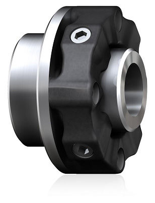

KTR Corporation
Develops EVOLASTIC Coupling
KTR developed a new all-purpose coupling for use in a broad range of applications from main to auxiliary drives in construction equipment and general industry. The zero-backlash and torsionally soft EVOLASTIC is available in ten base sizes and with variants in between covering nominal torques from 100 to 5,600 Nm. Spacers for large DBSE (distance between shaft ends) applications are also available.
The heart of the EVOLASTIC is a new, non-shear elastomer element that transmits torque through integrated aluminum jaw inside the optimized rubber profile. The elastomer is securely fastened to the hub and flange by radial and axial bolts which creates a designed prestress (similar to high strength concrete) that assures reliable torque transmission. The coupling requires low maintenance and compensates for permanent angular misalignments of up to 3° in a single plane while being able to accommodate significantly higher multi-plane misalignments than standard designs.
“Owing to its torsionally soft characteristics, the EVOLASTIC attains the requested vibration and acoustic insulation in the drive train. Besides torque transmission, the coupling also compensates for axial, radial and angular misalignment and absorbs overloads elastically,” said Jochen Exner, innovation manager at KTR’s think tank in Hilden, Germany.
The EVOLASTIC is the first new product release to evolve from KTR’s think tank which opened in 2019 and whose sole focus is new products.

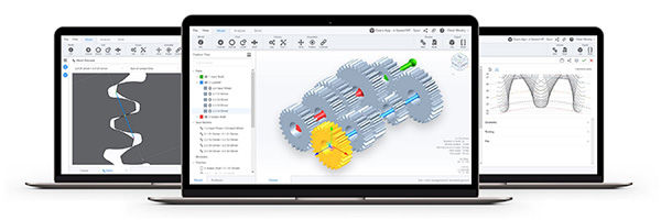

Drivetrain Hub
Launches Gears App
Drivetrain Hub has launched its fully web-based gear software, Gears App.
Gears App is the only Software-as-a-Service (SaaS) gear development platform that integrates gear system modeling, design-for-manufacturing, industry standards, powerflow analyses, CAD, FE, 3D printing, manufacturing, data management, and collaboration tools. Model, analyze, and build gear systems for parallel-axis and planetary architectures.
Gears App is accessible online from anywhere on any operating system, no special hardware, software, or complicated license required. It is the only professional gear engineering software made available as an affordable monthly subscription service, entirely online. Just open your web browser and start using it.

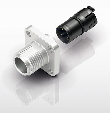

Binder
Expands M12-A Connector Portfolio
Binder USA, LP, has expanded its M12-A connector portfolio with two new rectangular flange connectors. Designed for today’s advanced automation technology, the connectors provide new options for sensor and actuator applications.
The M12-A connectors include a stranded-wire version with 20mm or 26 mm rectangular housing, and a solder version with 20 mm housing. (The stranded-wire 26 mm version uses the same drilling template as the M16, allowing users to switch to M12 without changing the existing housing.) For simple and reliable installation, binder used a two-part approach consisting of the housing and the contact holder, allowing the coding nose of the contact holder to be positioned in increments of 45°.

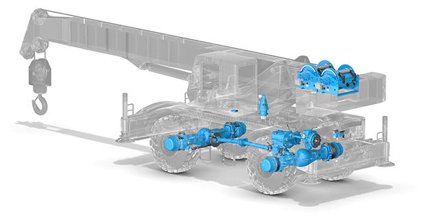

Introduces Heavy-Duty Drivetrain for Rough-Terrain Cranes
Dana Incorporated has introduced a new drivetrain for rough-terrain cranes with lift capacities from 83 to 110 tons (75 to 100 tonnes) and terminal tractors.
The Spicer 246 heavy-duty steer axle and Spicer C3300 remote torque converter are offered as part of a complete drivetrain solution for rough-terrain cranes that delivers premium performance through improved gradeability and travel speeds, higher efficiency in the field, increased productivity, and reduced operating costs.
“As the global construction market recovers, buyers are looking for high-performing vehicles that deliver exceptional productivity and efficiency,” said Aziz Aghili, president of Dana Off-Highway Drive and Motion Systems. “Dana’s large and growing capabilities for rough-terrain cranes enable us to anticipate market shifts and collaborate with original-equipment manufacturers to supply the drivetrain technologies that improve their competitiveness.”
New Heavy-Duty Spicer 246 Axle
Dana’s new heavy-duty Spicer 246 steer axle features a monolithic axle design and high integrity seals that deliver exceptional performance in the most severe working conditions. It features optimized steering geometries to minimize slippage, while the single universal joint design with outboard planetary gears provides high output torque and high-capacity braking with low drag at travel speeds.
Currently available for OEM field testing, the Spicer 246 axle can also be adapted for use with airport ground support vehicles, where it can be configured with optional wet brakes.
Efficient Spicer C3300 Remote Torque Converter
Dana has developed the new Spicer C3300 remote torque converter specifically for rough-terrain cranes. It is optimized for engines up to 195 kW (260 hp) and can be packaged with Spicer remote transmissions. Dana is the only manufacturer worldwide that supplies a remote torque converter with three large pump drives for implements.
The Spicer C3300 remote torque converter is available with an optional lockup that improves efficiency while providing higher braking effort during downhill operation. It features new converter wheel sizes configured to optimize the performance of today’s low-RPM engine designs.
Available now, the Spicer C3300 remote torque converter is already in use in terminal tractor applications, where it enables lower heights for fifth wheels.
Broad Portfolio of Drive and Motion Systems for Cranes
Dana has a large and growing selection of drive and motion technologies for manufacturers of tracked and wheeled cranes.
Earlier this year, Dana introduced a new series of Spicer Torque-Hub drives for crawler cranes and other large tracked vehicles. With torque ratings from 80,000 N-m up to 450,000 N-m, the new drives offer flexible packaging and gear ratios to meet manufacturer preferences for tracked and wheeled applications.
Also, Dana offers high-performance Brevini winches for cranes and other applications with lift capacities from 1.1 tons (990 kg) to 33 tons (30 tonnes).
Additionally, Dana supports the work functions of cranes with a wide selection of Brevini slew drives, hydraulic pumps and motors, and proportional directional valves.

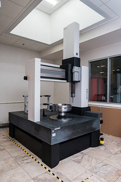

Adds Zeiss CMM to Quality Assurance Department
Forest City Gear has expanded the capabilities of its Quality Assurance Department with the addition of a Zeiss ACCURA Coordinate Measuring Machine.
The next-generation bridge-type Zeiss is Forest City Gear’s fourth CNC inspection system, and is particularly well suited for very fast, complete analytical inspection of all types of high precision fine- and medium-pitch cylindrical gears. A variety of interchangeable Zeiss sensors provide a high degree of flexibility and faster calibration, approach and scanning for lead, involute, pitch, surface finish and other critical features across a wide size range.
The system also features a particularly compact and ergonomic design, making it ideal for Forest City Gear’s fast-expanding, busy Quality Assurance room. The Zeiss ACCURA’s bridge, for example, is made of steel and aluminum, making it extremely rigid, yet slim and compact. The reduced weight of the moving parts improves the dynamic rigidity and speed of the machine.
“The added capacity of the Zeiss ACCURA has now enabled Forest City Gear to move its existing Zeiss CONTURA CMM to meet the quality requirements of its new, stand-alone gear blanking facility,” according to Forest City Gear Quality Assurance Lead, Amy Sovina. “The ACCURA couldn’t have arrived at a better time, freeing up the CONTURA so we could put it in close proximity to the blanking operation and thus eliminate the travel time for inspection of blanks,” says Sovina. “The Zeiss ACCURA checks all the metrology boxes. With quality and throughput requirements never higher in all the industries we serve, this system is the perfect addition.”

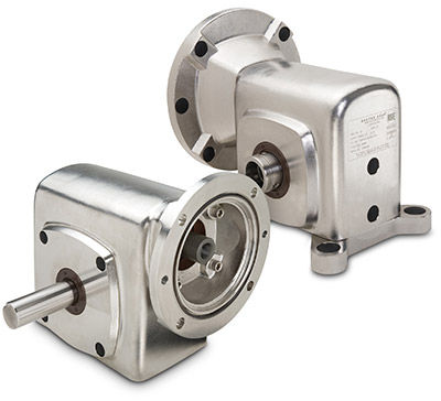

Provides Stainless Steel Powertrains for Coastal Manufacturing
Edited by Matthew Jaster, Senior Editor

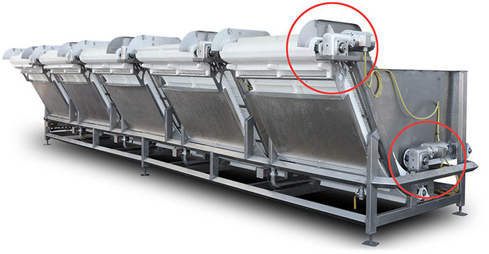

Hardly a day passes without a new FDA recall of some food product as the number of Americans falling ill from food contamination infections continues to rise.
While there are many causes of food poisoning, food processing equipment design plays a part. Motor and speed reducer drivetrains are found on all types of conveyors and equipment in food processing plants producing everything from beef and poultry to processed ready-to-eat products – in fact anything that people or their pets consume for nutrition or pleasure.
So, food processing equipment design, engineering and materials can play a big part in a plant’s drive for food safety excellence. Anything that can be done to minimize contamination and reduce the costs of sanitizing these units is a worthy investment.
Many drivetrains on food processing equipment feature belts, chains and external gears enclosed in a cover for safety. All of these provide very attractive homes for all types of bacteria and other contaminants. One solution is to utilize hollow shaft reducers, which allow conveyor drive rollers to mount directly to the reducer, eliminating the need for these bacteria harboring components.
Cast iron and aluminum speed reducers and motors are widely used in the food processing industry. Their lower initial cost compared to stainless steel models makes them attractive. However, if the life cycle cost is considered, that picture can change drastically. If the use of stainless steel reducers and motors helps to avoid a single line shutdown due to coating failure that could cause a contamination risk, the cost of the lost production may pay for the stainless steel several times over. Because of this, many manufacturers are moving to all stainless steel speed reducers and drive motors.
Boston Gear Stainless Steel 700 Series speed reducers were mounted to 3/4 hp stainless steel motors on conveyor drives in the system (photo courtesy of Coastal Manufacturing).
Besides the consequences and cost of a coating failure shutting down a production line, there is also the cost of keeping the line running. In one case, a poultry processor had laborers come in each weekend to paint and repaint gearboxes that had chipped paint or rust. This was done for each gear reducer at least once a year depending on the frequency of washdown. The cost of two of these re-coatings would have more than covered the cost differential between the gear reducers they were using and stainless steel gear reducers.
Coastal Manufacturing, a recognized industry leader, supplies custom designed equipment for food processing applications. According to Mark Hoffseth, a Coastal sales engineer, “Many of our customers face food safety audits that inspect every inch of their facilities and equipment, inside and out. Issues such as paint flaking or rust dripping in close proximity to a food contact area are unacceptable.”
This equipment is typically used in production 16 to 20 hours/ day with the remaining hours used to sanitize with a combination of high-pressure water, acids, and sanitizing agents. Hoffseth says, “In our experience, no carbon steel products, regardless of how robust or cutting-edge the coating or plating, have ever held up in this environment over time. There is no easy way on this one, we have tried virtually every ‘corrosion-resistant’ surface available, and stainless steel is the only long-term solution.”
For decades, the food processing and packaging industries have relied on Boston Gear 700 Series worm gear technology for long-lasting, high-quality performance. The Stainless Steel 700 Series takes that trusted performance to new levels by providing maximum corrosion resistance in the most challenging, caustic washdown environments.
Boston Gear reducers have the lowest maintenance requirement of any component they use at Coastal Manufacturing (photo courtesy of Altra Motion).
Hoffseth explained that when so-called “corrosion resistant” products fail, it is often much more costly to repair than with a stainless steel product. This is because, as they are failing, they are typically corroding and seizing onto the piece of equipment that they are mounted to. This can result in a far more difficult removal process, often damaging adjacent parts and components. Coastal has a 175-ton press in its shop, and there have been times when that press had to be used to remove seized, corroded parts. Typically, if that amount of force is required to remove a corroded part, there is often damage to other attached parts.
When asked about Coastal’s customers’ concerns regarding energy efficiency, cost of ownership, etc. Hoffseth said, “While these issues are important to everyone, I would say those are second-tier concerns. Food processing customers are mostly concerned with ‘is it food safe’? and ‘is this machine going to corrupt or harbor any product’? In most of the food and pharmaceutical areas that we work in, any equipment that contains corrosive parts is unacceptable. No question.”
Coastal had used painted speed reducers from Boston Gear and other manufacturers for at least 20 years and decided to standardize on Boston’s stainless steel units about 10 years ago. Hoffseth told us, “We have tried just about every brand of reducer – either due to customer specification or, often, because we are given other products to try out and there are some quality competitive reducers out there. But over the years, we have not found one that can beat the quality and availability of Boston Gear.”
Hoffseth acknowledged that Coastal has a very large number of Boston Gear stainless steel units in the field. While all parts wear and eventually require rebuilding or replacement, he said that the stainless steel Boston Gear reducers have the lowest maintenance requirement of any component they use. “We install them and forget about them, typically never having to hear about them or work on them again. For us, the bottom line is Boston has a quality product and has never missed a delivery due date. That’s the kind of company we want to work with, as that is the kind of company we are.”

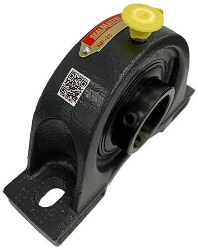

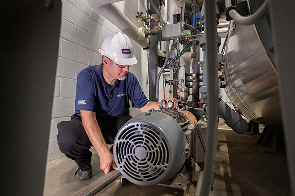

Regal Beloit Corporation recently announced it is now putting QR codes on Sealmaster and Browning mounted bearings products and bearing boxes including Browining, McGill, Rollway, Sealmaster and System Plast. Customers now have access to product specifications, including all critical dimensions and features, and the Regal 2D and 3D CAD libraries, installation and maintenance instructions, and much more. PTE recently caught up with Dan Phillips, CMRP, technical director, monitoring and diagnostics, Regal Beloit, to discuss the company’s digital strategies moving forward.
Dan Phillips is the CMRP, technical director, monitoring and diagnostics, Regal Beloit.
PTE: Explain how Regal’s QR codes make it easier to improve the customer experience in 2021.
Phillips: Regal continues to look for ways to improve the customer experience. For instance, the company has added QR codes to products so that customers can easily scan them to access a mobile-friendly version of our website for additional product information. From the landing page, a user can receive direction on where to find additional production information, how to register the bearing for an extended warranty, where to obtain maintenance and installation information, and learn where to make a purchase. Where possible, these QR codes are applied to Regal mounted bearing products and will soon be added to Regal gearing products. If not found directly on the product, these QR codes can also be found on our bearing boxes.
Regal has also launched the Perceptiv Tag-It program. Utilizing QR codes which plant personnel can apply to motors, speed reducers, bearings and other mechanical equipment, users can track assets, consolidate inventory, speed up the replacement order process, and upgrade to Regal remote monitoring and diagnostics services.
Perceptive Technologies install.
