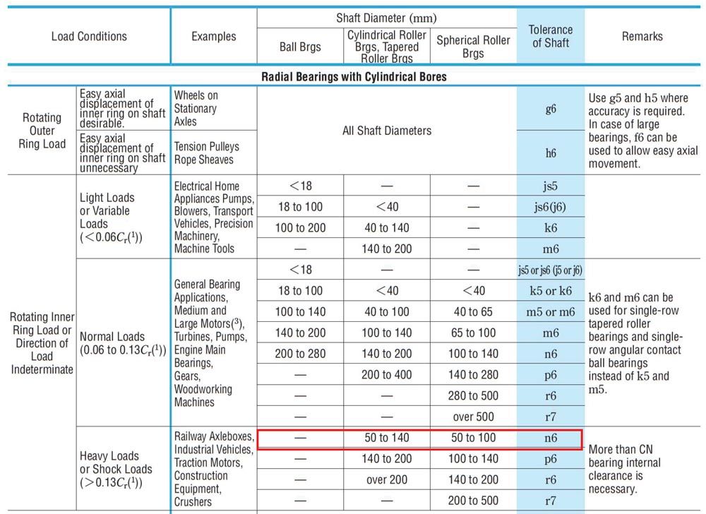

Now we consider our shaft tolerance range of 10–20 µm. If we review the standard shaft fit chart in Figure 2, we see that this custom range falls between m6 and n6.
If we review our standard fit table in Figure 3, you will notice on the load condition column that a Heavy Load is defined as > 13 percent of the dynamic load rating Cr. We have designed our creep loads for 50 percent of Cr, so falling near the n6 range makes perfect sense. Applying these fits is very easy. The 6205 inner ring bearing tolerance is 25 0/-0.010 mm. Bearings are usually written in negative unilateral tolerances like this. The nominal diameter (what we call it by), 25 mm is the largest diameter. We size our shaft by taking the bearing nominal bearing diameter and applying the fit tolerances. Our shaft diameter is simply 25.01–25.03 mm.
