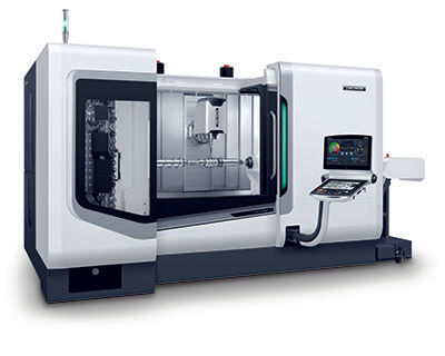

DMG Mori — Booth #1813
DMG Mori will demonstrate its gear milling portfolio with a focus on GearMILL software and various gear milling processes on multi-tasking machines. The solution’s approach, which combines the machine, tooling, inspection and software, will be on display to demonstrate different ways of making gears.
“The demonstrations center around the flexibility of the machines, which leads to greater productivity,” says Nitin Chaphalkar, product manager for the gear market for DMG Mori.
- Click image to enlarge
The booth will also have a display of their GearMILL software with latest machine cycle developments and part inspection capabilities. Machining of a variety of gears such as spiral bevels, spur, helical and internal gears will be demonstrated on this single machine. DMG Mori will also be presenting its solutions during presentations at the solutions center. The machine exhibited will be a NTX 2000 machine (a multi axis lathe) with second spindle and lower turret. This machine is capable of producing all types of gears using InvoMilling, flank milling (end mills), hobbing, gashing and power skiving processes. DMG Mori’s gear expert team will be on site to discuss possible machining processes for your parts and recommend solutions.

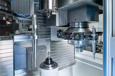

EMAG — Booth #1304
The new platform VT and VL Series for shafts and chucked components will be on display for visitors to experience the EMAG modular inverted vertical lathe design.
With the goal to develop a system of modular machines geared for use in the manufacturing of medium and large batch runs, EMAG offers flexible solutions on a standard platform. Single spline hobbing, for example, will be displayed on a VT vertical lathe for shafts. With the capability of offering gear cutting on a standard machine, EMAG modular machines offer increased flexibility. Machining is carried out in four axes at a maximum speed of 6,000 RPM. The process employs two turrets with twelve tool stations each, equipped with turning tools or driven tools. One common feature of all four VL machine sizes is the shared modular design. Their small footprint reduces floor space costs and increases flexibility in floor layout options. Every VL and VT machine features an integrated O-automation system for transporting workpieces.
When combined with the self-loading pick-up spindles, this automation concept ensures shorter cycle times and higher productivity. To accommodate machine operators, all the service units are easily within reach, with the various units (electrics, hydraulics, cooling system, cooling lubricant and central lubrication system) accessible at any time so that the machines can be maintained with ease. While the standard lathes are commonly used for gear blanks, a wide range of technologies can be incorporated into the machines, including turning, grinding, hobbing, chamfering, induction hardening and laser welding.
The technologies in the EMAG Group cover the entire spectrum of metalworking, including non-traditional processes. Laser welding is essential in lightweighting automotive components while electro-chemical machining (ECM) is a deburring option.

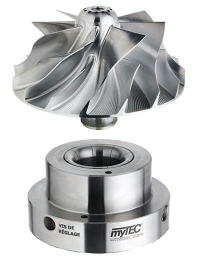

Euro-Tech — Booth #1704
Mytec is introducing its new line of mechanical arbors and chucks with accuracy down to .0004" plus high expansion rates up to .010" or greater in a stainless steel construction.
Mechanical arbors and chucks are designed for workholding where high forces are incurred or auto load applications where high clearance is required. A closed expansion system, which is impervious to dirt and chips, combined with high wear resistance, offers increased service life. If space permits, Hydra expansion elements from Mytec-Hydraclamp are generally equipped with an adjustment piston. This makes it possible to set expansion for fine clamping, particularly in the case of thin-walled workpieces, so deformation can be avoided.
Also on display will be Frenco’s INO system spline gages, an internal standard for the external dimensional measurement of spline gages based on national and international standards suited to even the most sensitive and complex components and systems. This product line provides a quick method of inspecting involute splines, serration splines and straight sided splines to ensure interchangeability of parts even between different manufacturers. Frenco spline gages are constructed of HX, a wear-resistant, high alloy, powder steel. This wear-resistant material allows for an improved extension in inspection intervals.

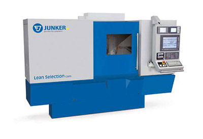

Erwin Junker Machinery — Booth #1026
The Junker Group will present its product diversity in gear manufacturing: Grinding machines from Junker and Zema in addition to air filters from LTA.
Junker’s portfolio has recently been expanded to include non-cylindrical grinding of camshafts for low to medium lot sizes. By using up to two highperformance grinding spindles, bearings journals and cam lobes can be rough and finish ground in a single clamping set-up. High powered grinding spindles, in combination with proven CBN grinding technology, guarantee the highest removal rates and performance.
The Lean Selection cam is capable of grinding all cam lobe profiles and geometries at high-speed – from concave to elliptical – and is suitable for manufacturing everything from prototypes to large production runs.
Zema will be demonstrating how its Numerika G-800 accomplishes the precision grinding of gear shafts. This durable, cylindrical grinding machine with its hydrostatic × and Z axes and hydrostatic grinding spindle reaches the tightest tolerances reliably and is suited for an unlimited array of work pieces. In addition, Zema also offers machines for ID/OD grinding and large shafts with diameters of up to 1 meter (40 inch) and up to 4 meters (157 inch) in length. The conversational control systems (Fanuc Based) offered by Zema are operator friendly, simple and convenient to use.

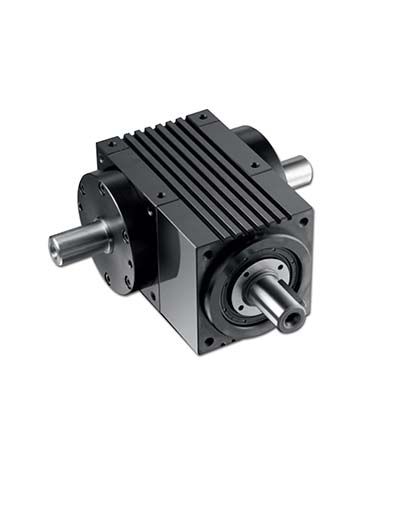

Exsys Tool — Booth #1731
Exsys Tool, Inc. will showcase its new line of high-quality Eppinger gearboxes and custom gear-making services for a wide variety of industries. Exsys just recently expanded its offerings of productivity enhancing systems into the gear sector.
Expo attendees will find spiral bevel, planetary, planetary bevel, hypoid, and cycloid-type gearboxes at Exsys’s booth, many of which are produced by Eppinger. They will also learn how to acquire specialty custom-made gears produced to their specifications.
Eppinger offers BT (bevel torque) and BM (bevel maximum torque) compact spiral bevel gears designed to bring high torque and maximum efficiency to gear applications that require a high degree of reliability and variability. Each of these bevel gearbox types offer minimized tooth clearance and optimal transmission properties via precision axes and bearing seats combined with Gleason bevel gears built to withstand high loads.
The single-component steel housings for these bevel gearboxes have mounting threads on all sides to ensure stable attachment in a variety of installation positions. The heavy-duty bevel gears inside these housings offer high-transmission precision and reduced stress on the bearings. A friction-locked, zero backlash connection of the crown gears on the drive shaft reduces the mass of the gearing component. Eppinger also offers PE (planetary eco) and PP (planetary precision) gearboxes designed for applications that require low backlash, high efficiency, shock resistance and a high torque-to-weight ratio. They have a modular design that combines ground gears and precision gear components.
The present range of planetary gearboxes comprises five sizes, with each size offered as a single, dual, or triple stage design. Each gearbox variant is also available as a precision design with reduced backlash. The wide range of sizes and designs allows users to achieve overall transmission ratios from i = 3:1 to i = 512:1 in a variety of applications.
Eppinger’s BP (bevel planetary) gearboxes combine features of the company’s BT series gearboxes with the pre-stages of its PE gearboxes, creating an innovative solution for various applications. The stable housing design and hardened, super-finished gear components of these gearboxes help ensure smooth running and constant backlash control.
These planetary bevel gearboxes achieve high-output torque and transmission ratios up to i = 320. Currently offered in eight sizes, the planetary bevel gearboxes easily mount to a wide range of motors.

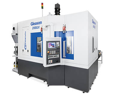

Gleason — Booth #1017
The Gleason Corporation will be showcasing a selection of its grinding and inspection machinery.
The Genesis 200GX threaded wheel grinding machine is Gleason’s latest addition to the Genesis series and offers many features. The two spindle concept combines increased productivity with minimized idle and set up times. Fast, easy software-guided setup of the machine allows you to set up machines from one workpiece to another in just 20 minutes using only one tool. Fully automatic workflow after setup until grinding the first workpieces and the ability to interface with Gleason GMS machines via QR codes increases productivity. Easily accessible machine components make maintenance simpler and more efficient while standard dimension grinding wheels and dressing tools allow you to use your existing tools. All of this in an energy efficient small footprint machine designed to meet the needs of customers in high-productivity, highquality environments.
The Gleason 300GMSP analytical gear inspection system is designed to operate in production environments while yielding reliable measurement results. A patent-pending base design includes an active leveling system to attenuate a broad spectrum of normal production environment vibrations, yielding measurement values in parallel with those achieved in controlled calibration laboratories, but without the delay of having to move to the lab location.
Thermal fluctuations normally associated with shop floor environments are proactively compensated for as well, allowing for the best possible and most reliable inspection results. The system identifies and applies a compensation for factory floor influences in real time. The 300GMSP is designed and tested to perform as a turn-key gear inspection system in the manufacturing environment.
Visitors to Gleason — Booth #1017 will also be introduced to a number of other products, technologies and services, including: Gleason’s complete line of gear cutting tool solutions and advanced workholding solutions.

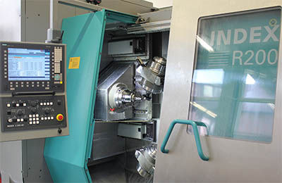

Index — Booth #1653
Index recently developed a “bevel gear hobbing” package, which consists of a specially designed control cycle and four Index cutter heads with module-dependent inserts. Equipped with these features, the Index R200 and Index R300 turn-mill centers become gear cutting machines on which spiral bevel gears can be produced – from bar stock, with front and rear end machining, complete in one setup or as a pure two-spindle gear cutting machine.
By hobbing using a continuous indexing method – which corresponds to the Klingelnberg Cyclo-Palloid method 1) – spiral bevel gears can be produced with constant tooth height in a module range of 0.6 to 4 mm.
Compared to the conventional process chain with classic gear cutting machines, users can achieve shorter cycle times and better geometry and position tolerances.
“The starting point of the development by Index lies in its own manufacturing governed by the principle: quality- determining components are made in-house,” says Dr. Volker Sellmeier, Index-Werke head of technology development. “When the tool holder production was reorganized several years ago, the decision was made to produce the required bevel gears ourselves.”
Bevel gear cutting requires a machine with high rigidity and a B-axis as the basis. Due to their increased static, dynamic and thermal properties, the turn-mill centers of the Index R-series are designed to gear-cutting, provided they are equipped with the “bevel gear hobbing” technology package. The R machines’ axis configuration with two milling spindles on Y-B-axes running in hydrostatic bearings makes it possible to machine on the main and counter spindle simultaneously in five axes.
The ability of the turn-mills to accomplish complete gear-part machining on the front and rear ends simultaneously results in shorter total cycle times and lower cost per piece.
“When we machine typical bevel gears with module 1.15 mm and approximately 25 teeth for our tool holders completely from bar stock, we achieve a cycle time of less than 3 min. The share of gear cutting amounts to about 30 seconds,” Dr. Sellmeier says.
In a classical gear process chain, the workpiece has to be set up on several individual machines for turning, drilling, and milling, gear cutting and deburring. Index’s approach is to run all operations on the turn-mill center. Bevel gears are turned, drilled, milled and finally cut on a single machine. Even brushes for deburring can be set up. The soft machining process is thus completely autonomous, according to Index with a process-reliable gear quality of IT5. This is then followed by hardening. A final finishing process is usually required only for the mounting distance and the polygonal shaft/hub connection.
The Index solution works for both contract manufacturers, which need to produce small lot sizes with high flexibility, and mass producers, which want to produce bevel gears in large quantities at minimal cost. The investment is relatively low compared with specialized machines. Also the consumption costs are kept within manageable limits, since the cutter heads are equipped with interchangeable inserts.
Flexibility is high: In addition to bar stock machining, which is best primarily for small quantities, for series production the R machine can be used as a pure gear cutting machine, working on the main and counter spindles simultaneously.
“This requires the use of an automated workpiece-loading and unloading system that loads the blanks and removes the finished parts gently,” said Dr. Sellmeier. “We offer a quadruple gripper with two stations on the main and counter spindle that picks up the finished parts, rotates and then loads new blanks. This way we use the machine as a kind of double-spindle machine, cutting the time per piece in half.”
Two cutter heads are required per bevel gear. They differ slightly in their cutting circle radius in order to produce the longitudinal crowning. Index offers the cutter heads in four different sizes that can be fitted with up to six carbide inserts and feature internal cooling.
In contrast to the typical Cyclo-Palloid method with an interlocking cutter head, the Index method uses two separate cutter heads per bevel gear.
A control cycle developed by Index is another essential part of the technology package. The user enters there the same parameters as on a conventional gear cutting machine. These include, for example, machine distance, eccentricity and auxiliary angle. The cycle translates these values into the movements of each axis so that at the end the same relative movements are effected as on a conventional gear cutting machine.

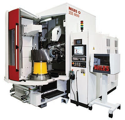

Kapp Group — Booth #2222
Kapp Niles will be showcasing its ZE 800 profile gear grinder while R&P Metrology GmbH will present its PM 750/1250 portable gear inspection system.
The ZE 800 offers a compact yet highly productive solution for a range of applications. The machine is capable for 25 module (1 DP) external gears and is prepared for internal grinding using either CBN or dressable wheels. It will be shown with new software features including hob and worm grinding.
R&P’s PM 750/1250 is the first portable gear checker/CMM with dual functionality for use in the lab or on the production floor. Its flexibility enables the measuring of larger gears on production machines that may not have onboard inspection. The design makes it moveable within the plant. The optional “docking station” with granite base and rotary table allows the PM 750/1250 to become a stand-alone, fully featured four axis generative gear inspection machine when not required for portable measurement.
Kapp CBN tools for direct grinding, and DIA dressers for grinding and honing are also featured at the booth, along with grinding experts, on hand to answer questions.

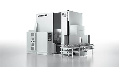

Liebherr Gear Technology — Booth #1809
For Platform 2 (LSE/LFS 200 to 500) and Platform 3 (LSE/LSF 600 to 1600) machines, Liebherr Gear Technology is introducing a smaller shaping head option which facilitates electronically controlled machining of spur and helical gear teeth.
“The smaller SKE 120 shaping head enables users to machine a considerably wider range of components on our Platform 2 and Platform 3 gear-shaping machines,” says Dr. Hansjörg Geiser, manager development and design gear cutting machines at Liebherr- Verzahntechnik GmbH. “We are thus better able to meet contract manufacturers’ gear-cutting requirements.”
The new SKE 120 shaping head with highly dynamic rotary drive and moveable shaping head slide occupies less space at a stroke length of 120 mm. The design engineers used the space gained to enlarge the stroke position travel range on Platform 2 machines. The SKE 120’s stroke position travel range, at 650 mm on Platform 2 machines, is more than twice as large as that of the SKE 240, which is 300 mm. The same applies to Platform 3 machines where the difference is 350 mm. Even 900 mm are feasible if raised column slides are used. The shaping spindle is hydrostatically mounted and channeled.
Some workpieces require a longer stroke length (for wider teeth), while others require a wider stroke position travel range (longer workpieces with correspondingly higher gear teeth). The optionally available NC swivel column slide, which lets you produce conical gear teeth at a shaping spindle angle of between -1° and +12°, has been optimized to achieve a higher degree of rigidity. If NC swivel column slides are not used, the shaping spindle angle can be adjusted by up to ±0.45° using a cam.
The direct-drive electronic lead guide provides users with latitude and flexibility. They only need enter a helix angle of between 0° and 45° and the control system calculates the rest. The new SKE 120 shaping head differs primarily from the larger shaping head with electronic lead guide, SKE 240, by a smaller stroke length. The crank drive features automatic mass counterbalance, which ensures optimum concentricity. The spindle itself has a somewhat narrower design than the SKE 240, which has a positive impact on interference conditions.
SKE 120 and SKE 240 shaping heads featuring the electronic lead guide provide contract manufacturers with a range of new opportunities. For example, frequent workpiece changeovers are easier.
To be able to machine different helix angles on gears, the motion of the shaping head must replicate the gear´s helix angle. This can be performed by a mechanical lead guide. Set-up times are shortened because where an electronic lead guide is used only the shaping tool needs to be changed, if at all.
An added benefit is that customers do not have to invest in multiple lead guides. They are not dependent on the control’s processing time, which makes them even more flexible. Added opportunities are provided in combination with the stroke position adjustment detail.
A further requirement was the ability to manufacture efficiently and to optimum quality, in addition to the flexible range of workpieces. The process itself is highly productive, given the high number of strokes at 1,200 double strokes per minute. This figure is based on a dynamic drive mechanism combined with effective control technology at optimum rigidity.
Liebherr developed its Type LSE range of machines based on its proven LFS machines. Besides the option of using electronic lead guides, these machines also enable you to correct helix angles. Tooth flank angular deviation (fh) can be corrected simply and precisely when setting up the shaping machine.
It is possible to retain the helix angle for subsequent tempering. For even better quality, μm corrections can be undertaken: the machine achieves tooth flank quality grade 4 as per DIN3962-2.
Along with increased quality and flexibility requirements, materials have also changed. For example the tensile strength of workpieces to be shaped has increased substantially. The LFS/LSE machines have been designed to shape high-strength materials.

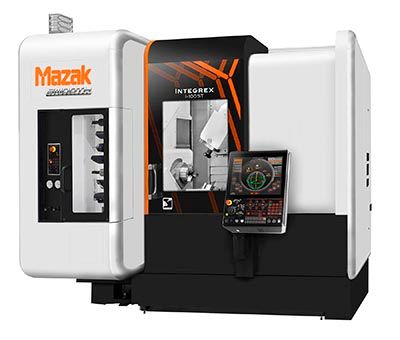

Mazak — Booth #1322
At Gear Expo 2015 in booth 1322, Mazak will use its Integrex i-100ST, equipped with the latest Mazatrol SmoothX CNC, to demonstrate how advanced multitasking machines can effectively perform today’s gear-making processes, from hobbing to skiving to gashing.
Mazak multitasking machines, including the Integrex i-100ST and over 90 other model configurations, when paired with the right software and CAD/ CAM system, can serve as adaptive gear machining solutions that produce precision gears of all shapes and sizes. Unlike dedicated gear cutting equipment, these machines have the flexibility to perform a variety of operations in a single setup.
Shops with occasional gear work, for example, can use a Mazak multitasking machine to turn a part’s I.D. and O.D., process its mating features, and power skive its gear tooth pattern. Performing all of these functions on one machine improves overall accuracy because every part feature runs true to the gear teeth. And, when the machine is not busy with gear work, it can continue to earn its keep by processing a range of complex, non-gear components.
One of the most compact models in the Mazak multitasking machine family, the Integrex i-100ST, processes small complex workpieces in single setups. It employs two 15-hp, 6,000-rpm turning spindles, a nine-tool lower turret and a 10-hp, 12,000-rpm milling spindle. Each turning spindle features a 6" chuck with a 2.4" bore size that can accommodate bar stock of up to 2" in diameter. The machine’s 36-tool magazine accommodates tools up to 5.1" in diameter when neighboring stations are empty and up to 3.5" in diameter when stations are occupied.
Gear Expo attendees will be among the first to see the Integrex i-100ST equipped with the new Smooth Technology process-performance platform, which has transformed the way the company’s multi-axis machines perform. According to Mazak, new CNC technology, progressive machine design and unequaled engineering resources set the foundation for the platform and, together, provide users with unsurpassed ease of operation and unmatched productivity.
The Mazatrol SmoothX CNC, a key element of Smooth Technology, operates four times faster than Mazak’s previous-generation controls. Gear makers, especially, will benefit from faster rotary axis speeds, which allow the machine tool to quickly perform gear hobbing and skiving operations.
Gear Expo attendees can also inquire about the company’s other gear production options while in booth 1322. The company’s larger multitasking machines with full 5-axis capabilities are known for being able to produce low-volume spiral-bevel gear sets. The Integrex e-1550V/10, for example, can machine a spiral-bevel gear set with a 29-tooth, 22"-diameter pinion gear and a 114- tooth, 6’-diameter gear ring in a matter of days as opposed to months.
